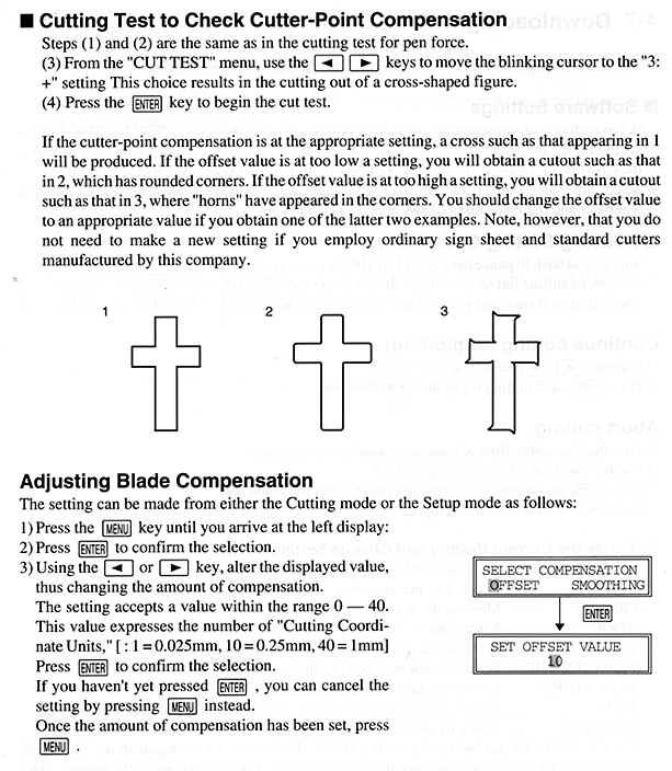

Trying to figure out how to change the blade offset...Getting that "not finishing" cuts and was thinking my offset was out of wack. I have a 45degree blade and trying to offset it to .250mm.

Here's the page on setting offset. They use a weird number scale rather than direct measurements in mm.
