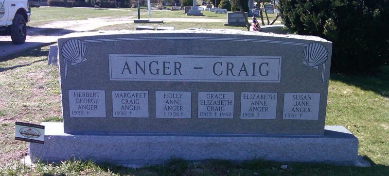

here's a recently completed stone I did. (installed today)
5-0 x 0-8 x 2-4 - Barre Gray Die
6-6 X 1-0 x 0-8 - Base
Top piece was 1679lbs alone!
