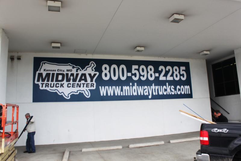

Does anybody see a distinct advantage to alumacorr over polymetal for an outdoor sign panel being mounted directly to a building? See my attached pictures, I did the midway ford sign out of polymetal and the baseball sign out of alumacorr. Wondering if there is significant different in durability, ease of installing, etc. etc.
Thoughts?

10mm alumacor is thicker and more rigid.. more so than a sheet of polymetal, even the 6mm polymetal. It's also lighter. It really depends on your application.
Alumacor dents easy compared to poly metal.

They basically are the same thing. On a flat surface such as a wall or solid frame post and panel job the polymetal works great. If there is a lack of support behind the polymetal it will flex and bend quickly.
Alumacorr is what we use for cheap and easy post and panel jobs where cross members aren't really needed.
