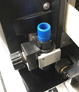

ours doesn't look like it has two positions...
