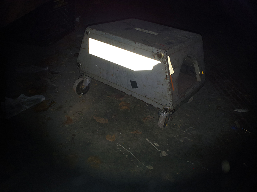

We've had this as long as I can remember. Someone gave it to me, back in the 70's. It's served me well. It was already old when I got it.
You can use it as a step stool by turning it on it's side and it's easy to carry. Put the reflective on it, so we can see it when the lights are off by shining a light around.

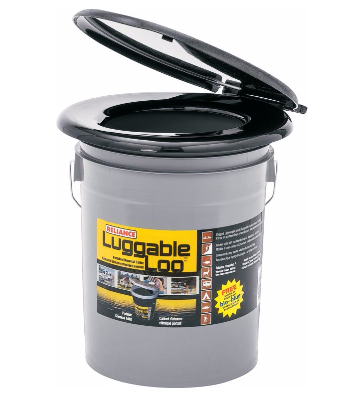

The ultimate portable seat for the long trips and wrapping semis all day.

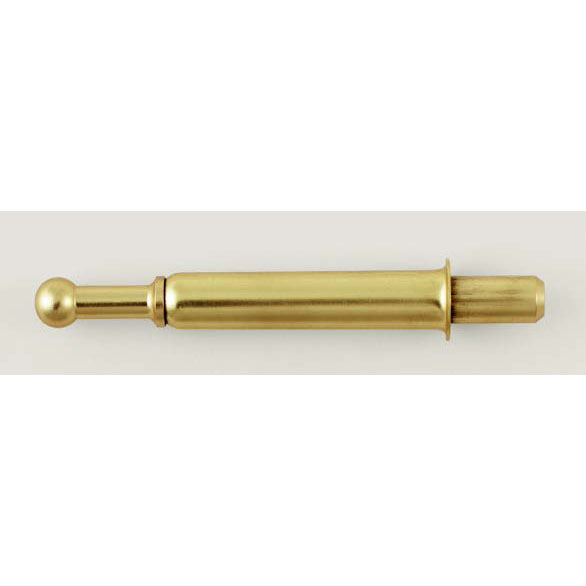

The heart of the stool is a pair of spring-loaded pins, similar to the picture below, mounted to the inside box. The pins enter evenly spaced holes drilled into the sides of the outside box, holding the inside box at its various heights. A simple linkage pulls the pins inward when a ring is pulled up at the top of the inside box. I periodically rubbed the sides of the inside box with paraffin to keep the sliding action smooth.
The actual pins used have holes drilled in the little ball ends for attachment to the linkage that pulls them back. Other than that, the picture below looks just like them.
