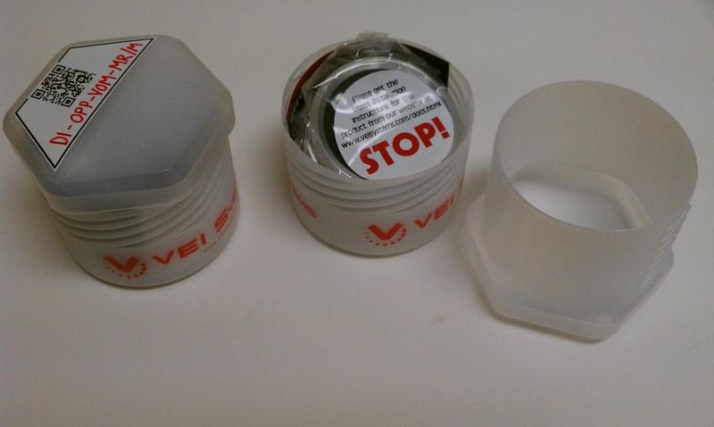

Yes, I am going to use UV guard for generic decals I make, but product decals have held up for years w just Oracal 651. Examples... the circular decal and the trapezoid on this package...

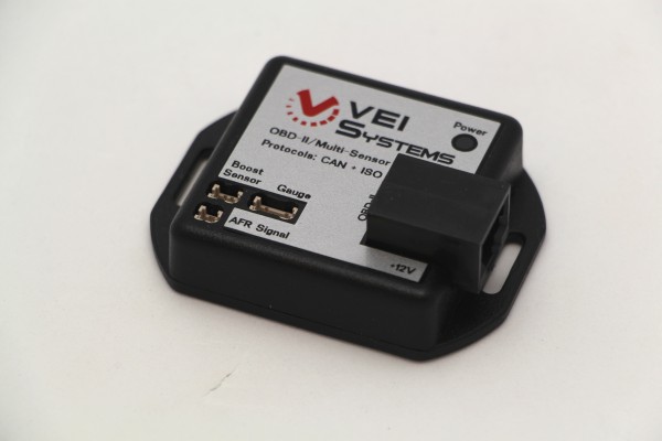

And decals like this, which would be hidden in the dash of a car...

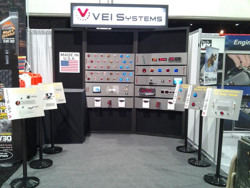

Yep... Learning this. My goal isn't to be in the sign/decal business, but it's nice to justify the purchase of this printer. I'll say again though that the convenience has been priceless. We were up late the night before going to this trade show, and printed just about everything here (except the top banner which I had from before) on the FX. If we had to plan and figure out every single decal in advance to get it done elsewhere, we would've been in trouble.
