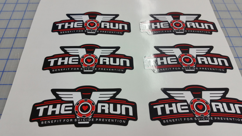

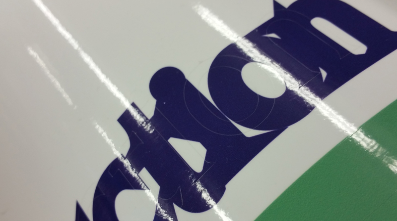

I would really appreciate any and all input that I can get with regards to a problem we are having with our Mimaki CJV150-130. I'm just wanting to get some feedback from other users and opinions before I speak with my technician. We purchased our printer/cutter a few months back and it's been a joy to own...for the most part. We run small print and cut jobs with basic cuts and we have no issues thus far. Basic shapes are cut with a good degree of precision, however anytime I throw something at it with 'complex' cuts, the cuts are very unpredictable, as in all over the place. For example, the attached photos show a completed job that had basic contour cuts and the job turned out just fine. I was printing and cutting over an area of about 24" x 12" and cutting them in sets of 9 just to be safe with no problems. Fast forward to the job I ran today, which is in the second two pics. These decals are roughly 30" x 9", so I rotated them 90 degrees and put them in groups of 5 across the 54" wide media. So on this job I'm basically cutting over about a 50" x 32" total print area using the recommended 25mm crop marks. As you can see, the cuts are not coming out anywhere near where they should be. They are about 1/2" off in the feed direction and 1/4" off in the print direction. I knew before I ran this job I should have probably just outsourced it to avoid any complications, but I wanted to see if the machine could handle it. Well, as you can see, it looks like I should have gone with my first instincts and just outsourced the job. Instead, I have a feeling I'm going to be pitching $90 worth of printed and laminated media in the dumpster.
So my question is, am I expecting way too much from a cut and print combo machine, or should this job be doable? I added a .100" bleed around the lettering, but it's not even cutting anywhere near the bleed area. Any insight and/or advice would be great before I continue to botch up more media. This machine has been great for the most part and is fully capable of running 95% of what I've thrown at it, but precision cutting has been a real issue with certain jobs.

Just my 2cents worth, it looks like in the set up the crop marks were off or the material wasn't running straight. I have had similar issues in the past with my Roland, but never that far off.
Ultimate13
It's tough to tell without seeing more pics, but are any of the letters close or is the entire cut off? Looks more like a setup problem or reading the marks incorrectly to be that far off. We use a Roland XC-540 and that is the only times we have trouble is when we screw something up in the setup after laminating and putting the material back in. It's clear you know how to run the machine since you got the contour cut right on in the first picture.
Things we look for - Don't get the media size again after laminating, also sometimes center on media is selected and shouldn't be or vice versa. Or some other box was checked when putting it back through that wasn't checked when printing.

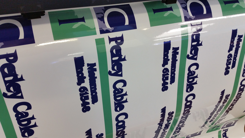

Well, here's an update. I had 20 decals to cut, each group of five decals with it's own registration marks for a total of four groups to cut on a big sheet of 54" x 12 foot media. The first set of cuts I ran started close to where they should have been then skewed way off shortly after, ending with the cuts shown in the 3rd pic. The 2nd and 3rd groups of decals cut just fine all the way through, with relatively perfect accuracy. And the fourth group did the same as the first with cuts that were way off the mark, even from the start. Can the weight of the media hanging off the front or back of the machine cause problems when cutting? That's the only remotely logical thing I can think of. The cuts are definitely shifting around at some point like the media wasn't feeding right or something. Do I want to use the media hold downs along the edges of the media when cutting? I did notice the media along the outer edges jumping around a bit, but figured I really only needed the hold downs when printing to prevent head strikes, or do they help with cutting, too?
I will say that I now have to reprint 10 decals, so instead of setting them up in groups of five with 25 mm marks, I set them up individually with the recommended 15 mm marks. I'll have to locate the registration marks for each decal now, which is going to kill my productivity on this job, but I feel I have a better chance of getting accurate cuts by employing that option. I definitely don't want to screw up any more material. The thing is, I've run probably a dozen or more print and cut jobs up until this point with great success. But all were basic cuts and they were grouped in relatively small groups. With this job, the decals are fairly large and I figured I'd test the waters and see if detailed contour cutting on a 50" x 32" area was possible and as it stands my odds of success seem to be 50/50. I just hope I'm not expecting too much from this machine, but I don't want my productivity to suffer either.
That's true, I may not have had it lined up perfectly the first time around. I used a makeshift 60" straight edge cut from a piece of 1/8" pvc to visually line the material up the last 3 times, but my fourth set of cuts were still off just like the first. And that's the thing, I ended up having to realign the media for every group of cuts because the material seemed to be shifting around slightly throughout the cutting process, at least on the first and fourth group of cuts it was noticeably shifting.
The cuts started fairly close to where they should have been, but they were still off maybe a 1/16" to 1/8" in the feed direction. Then as the machine continued to cut, the cuts were getting farther and farther off, which happened not too far into the cutting process. It almost seemed like on the first group I cut, the material moved early on and the majority of everything else was way off at that point. The fourth set of cuts happened in a similar fashion.
