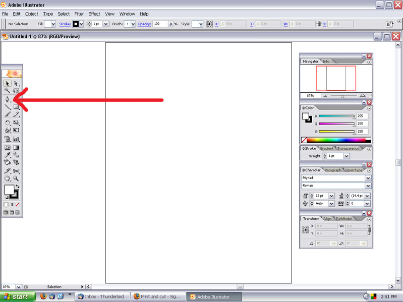

The instructions I supplied you were tailored to using Illustrator for the path creation. The Bezier pen tool shares space with a few other related tools on a "flyout". See the attachment.
Silhouetting in Photoshop does not create a path. Using the magnetic lasso will tend to give you a very pixelated edge, so if you use it to create a path in Photoshop you will likely not be pleased with the edge quality for cutting. You would have been far better off, if you felt you wanted to do this in Photoshop, to use the Bezier pen tool in Photoshop and then export the path to Illustrator.
The quickest way to a happy ending will be to follow my original instructions using the Bezier pen tool in Illustrator.

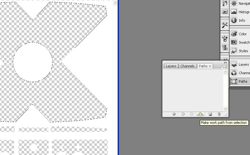

While you have the "selection" still around your image, you can click on the paths palette and make work path:

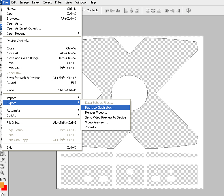

Then you can export the paths to Illustrator:

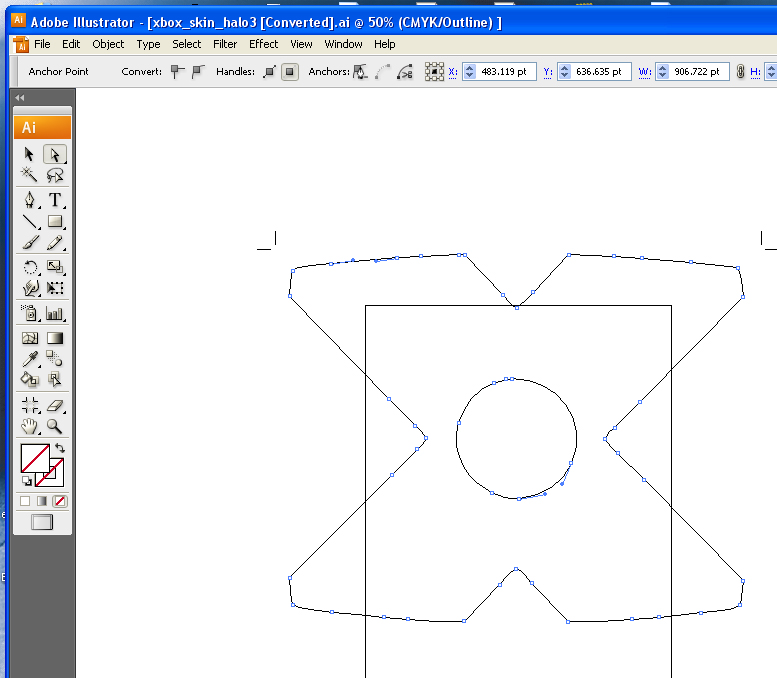

Then you can open that file in Illustrator and see your paths:
You can then import your picture into Illustrator and line it up with the "contour", save as an eps or what ever file type you need. I usually don't work in illustrator at all, I take a few more steps to get it into corel where I feel more comfortable. This method has worked for me quite often...

Like Fred said above, the path's aren't always the cleanest. I usually do some node editing when I get the file where I finally want it. This was the "quick and dirty" method I've used at times.
Gene

I followed Gene's steps and it was easier until I opened the file in Illy and I got a blank page - no paths, nothing. I need to figure this out.
In Illustrator, on the top menu, go to View> Outline. You can always drag across the screen with the selection tools too and it will select the object.
Gene
The Dotted Line
The Dotted Line
As njsigns said, the work path that comes in, exported from Photoshop, typically comes in with no color for the stroke or the fill. This meaning that you will see nothing unless you go to view it in outline form. You can also, upon opening it, do a Select All, and then change the stroke color from None which is the default to black or any color from the swatch palette.
