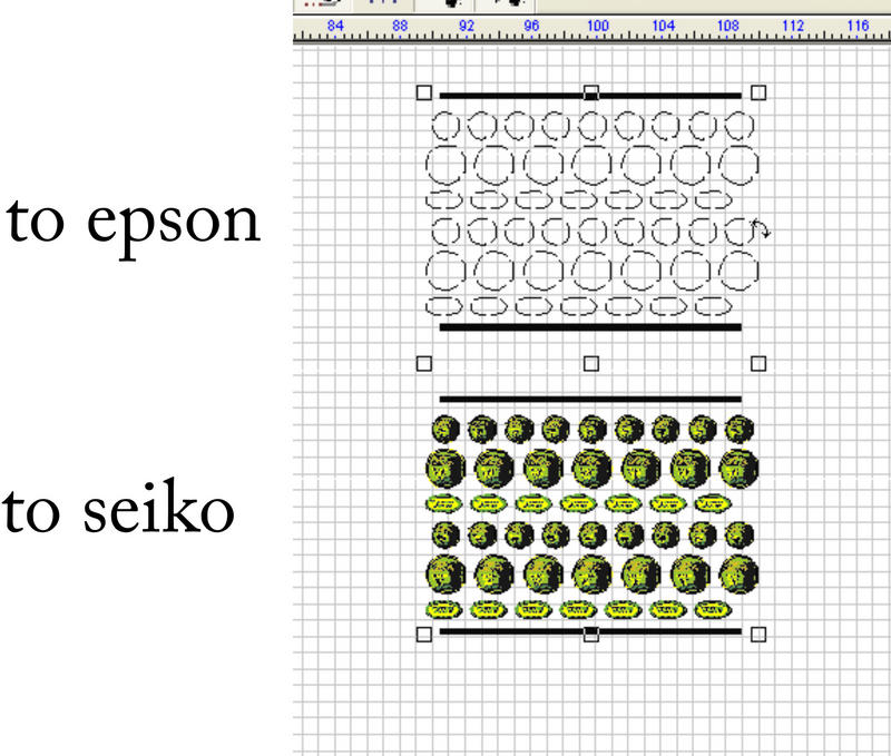

I just today did some fine detail label printing on my pigment printer (epson 10600) that my seiko just can't do crisp because of small size of text and then printed the contour cut and crops on laminate on the seiko. Lined up laminate and print and now have crops that will read and cut. Signlab geeks couldn't make the epson print/cut even though they said they could so this is my workaround. Little more labor intensive than I like but it got the job done nice and clean.
