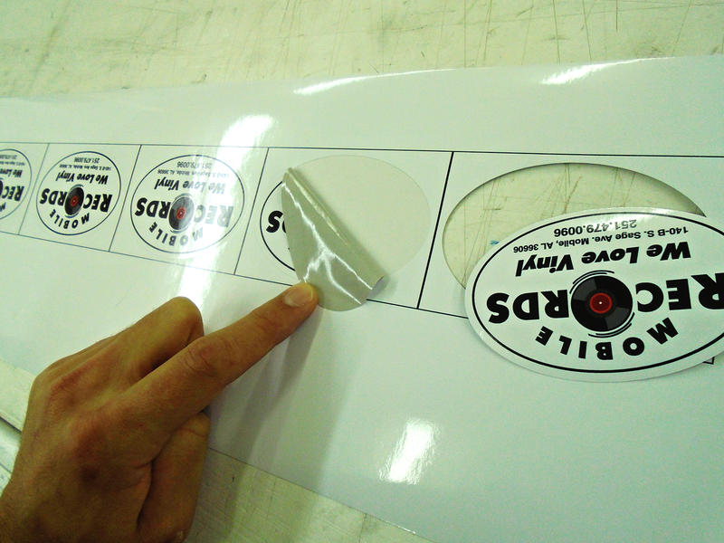

I recently replaced the blade on my VS540-i, then sent a set of 2x3 oval decals to print/cut.
For some reason, the first decal gets cut completely out of the vinyl - the rest are fine - I made sure to decrease my pressure after replacing the blade but I'm not sure if I installed the blade incorrectly or what - anyone have an idea?

did you do the repeat in versaworks or in the original file?
if you did the repeat in the original file check to make sure you don't have 2 cut lines overlapped. if you do it will cut twice on the same decal

I did the repeat in Versaworks - my supervisor said it may have made more than one pass but I've checked that as well and watched the cutting take place - one single pass on each decal, just the first one gets cut completely out.

that's weird. did you try importing the file again and starting from scratch? i would try that next if that doesn't work then i have no clue.

If Visbily isnt cutting twice, it's likely the pressure. Having a bad cutter strip would probably give you jagged cuts, and those look clean, so likely fine there.
In the job setting->cut controls, how is the force controlled, manually or by the job settings? I think you can control settings per image, try clicking to highlight each decal to see if they have different force values.

So I checked, resaved and reimported the file Friday to no avail. When I got to work today I rechecked, resaved (with different name) and re-reimported, and it worked.
Why it worked is a mystery. Why it wouldn't work to begin with remains one as well.

unfortunately unexplained things happen with these machines from time to time. not on a regular basis but it happens. and when i say unexplained i mean it's just beyond my knowledge of the machine. glad it finally worked out.
