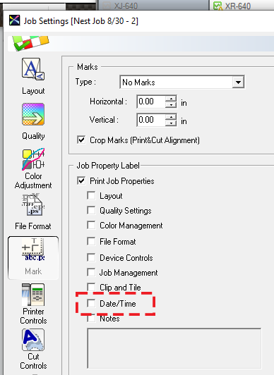

We use Roland Versaworks 5.5 and 6.2. Does anyone know of a way to easily print a julian date code on each product that we produce? Is there a Variable data option to add that? If not in Versaworks, is there another RIP that can do this?

You can print the job properties - including the date under Marks
