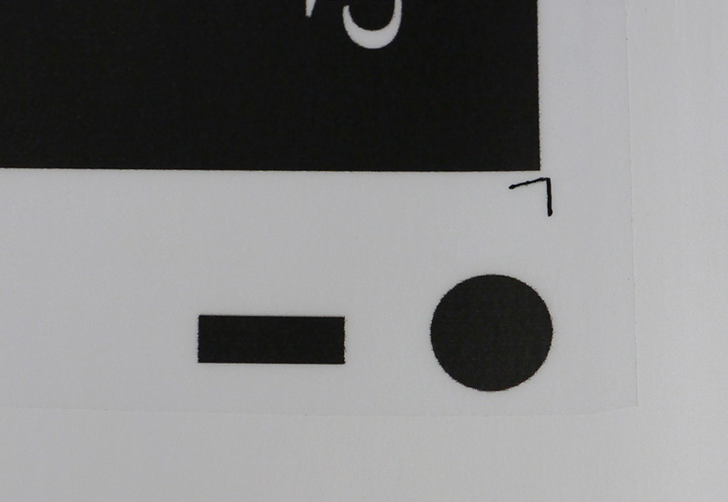

Here's another thing that might be the culprit? The fine/small registration marks (which I've gone over with a fine felt pen) are really close to the black block of printed ink. Could that be throwing it off?
Colin
I've answered my own question - that was it! I placed a tiny triangle of white cast vinyl on the corner of the black block of printed ink, and that solved the problem.
Thanks for the tips & input!
T_K
Glad you got it working. I'm still not sure why that printed area would make a difference. It scans the circle and the rectangle for registration. The "V" near the print is just for a manual alignment. But if covering up the print works, great!
