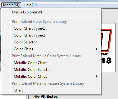

peavey123 is correct... they are only headings.
attachment.php
Every VW machine we have here displays it just like that and I can't remember it ever being different.
