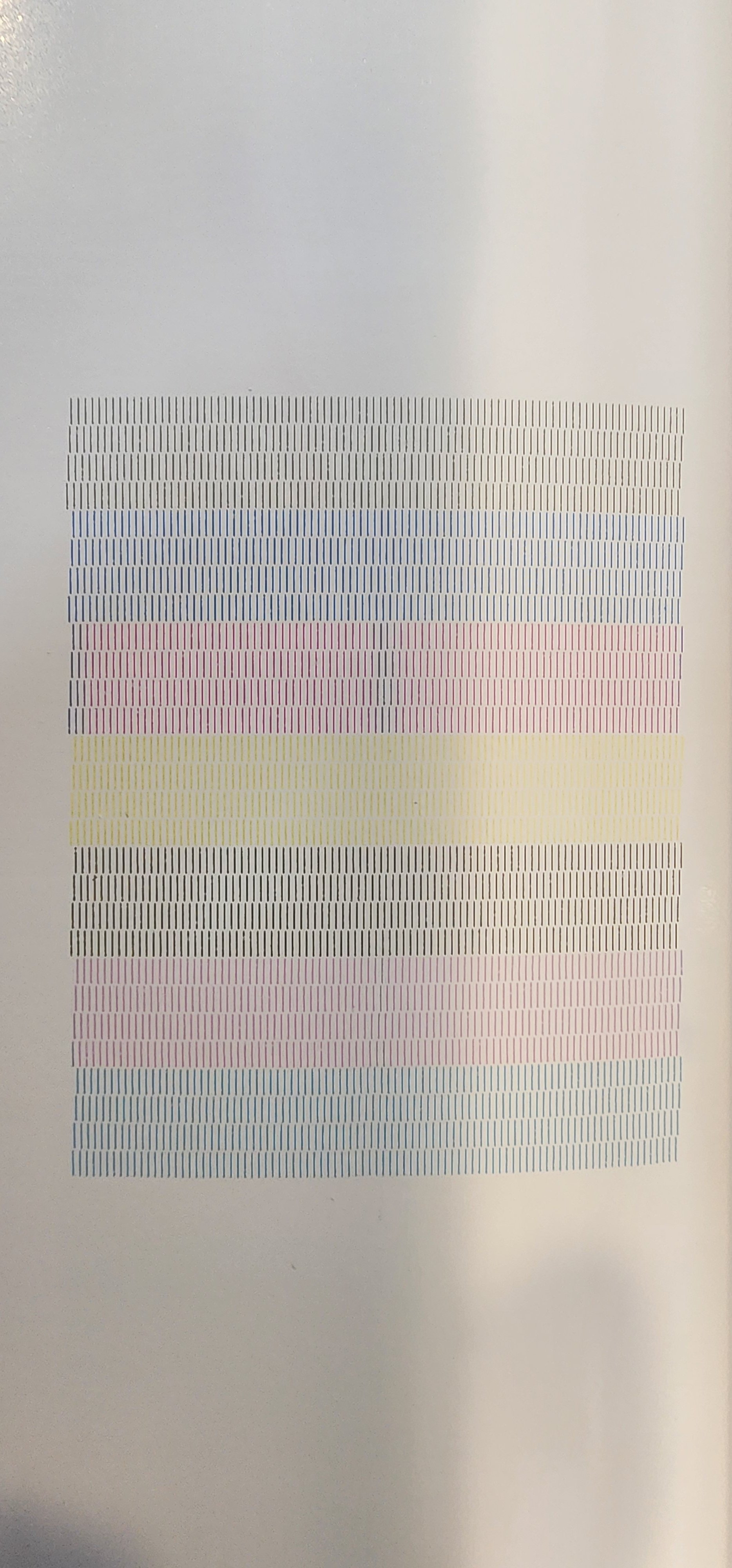

I have never seen this, did a light choke and went from the better test to where the cyan is wavy.....

Run another couple of test prints and see if it does the same. Sometimes the printer can just throw up a weird signal that makes a head print strangely
damonCA21
Have you cleaned the surface of the print head manually as it looks like you also have hair on the black channel. It may be a blob of something is deflecting the print
damonCA21
In fact zooming in you seem to have hairs over most of the print head face as there are things showing up all over the test print. Have you replaced your wiper recently or cleaned it?
