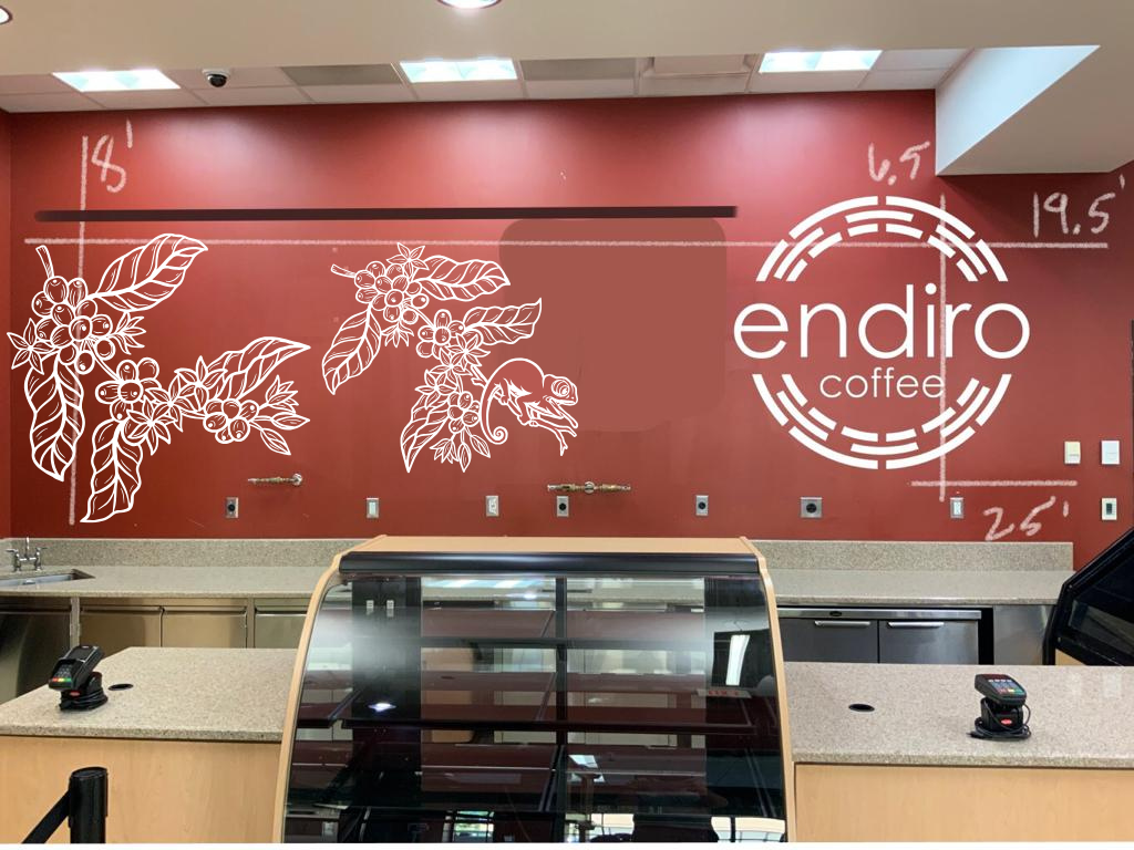

i just ran 3 logos at 52"ea on IJ35 and weeded out super nice. just take your time or it will rip on sharp corners.
pic is for mock up of location not actual install.
