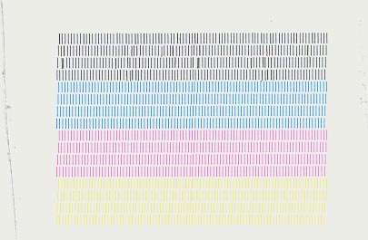

The black on the test print has lines missing and out of place. I have done a standard and powerful clean on it and tried to suck ink through it with a syringe nothing has helped. what should I do?
visiongfx
Here is a pic of the test print

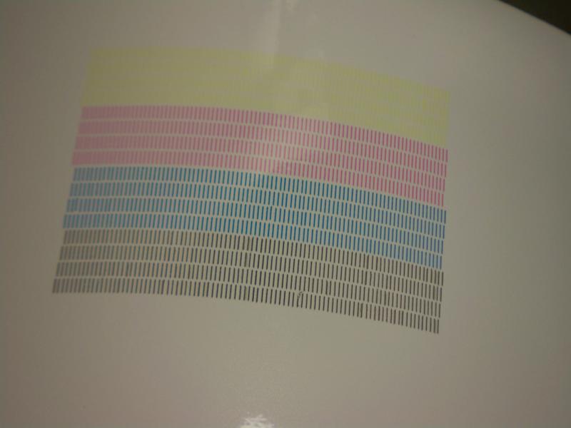

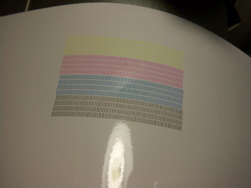

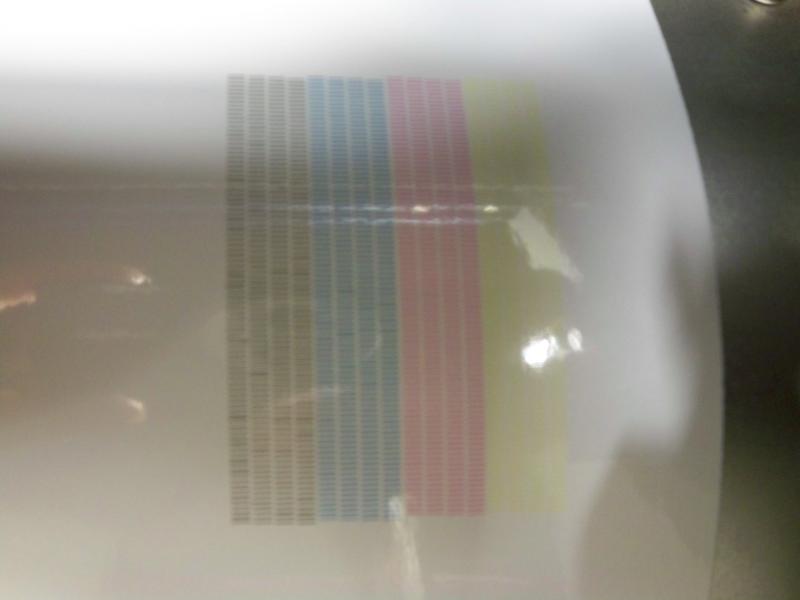

wow that looks good to me. My black is slightly worse than that and i have no problems at all with print quality. I think it is just from time, I keep my printer very clean. One of these days i will take that head out and soak it in the heated sonic cleaner and that should clear it up.
My black looks a little sloppy and mis-aligned and 3-4 cyan's too.

zmatalucci
well, the black head is the first inline, so any time you have a head strike,,, it damages that head first. I have replaced my head once because of banner material not being unwound at the back of the printer.
