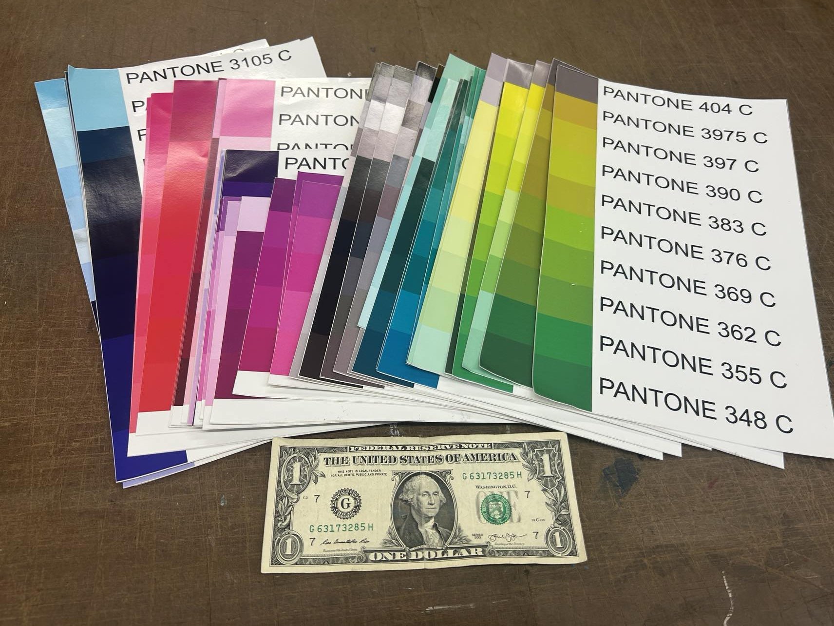

I printed the PMS Coated Swatches and made a little book with a large binder clip. As you can see, it's very homemade - but it works!
I also will print little samples of customers logos and save the swatch naming it "Joes Lawn Green" "Pigeon River Blue" etc.
When I design a logo or suggest colors for things I try and use the colors I know print well, like "Pigeon River Blue" etc. because those usually are matched up with Oracal vinyl color and an ink color for screen printing.
Very boring - yes. Does it make things easy for me - yes.
