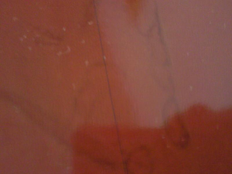

When i printing im getting a terrible looking print, Like if i print a red square it will have some really light black in it, not be like its suppose to be. What i did last night was pressed delete for a job and actually deleted the printer off :doh: So i tried resetting it like it was not sure if i got it right or something else is wrong, I also went ahead and cleaned it last night thought that might of been the problem but that wasn't it. This printer is like 4 weeks old so it still new. Any help would be great, Its a mutoh 1614 64" using flexiPRO with windows xp thanks

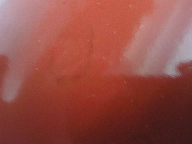

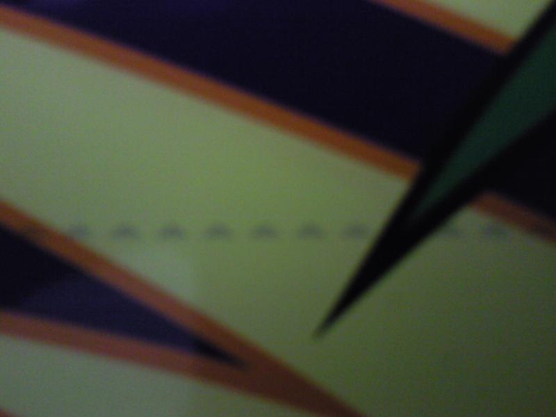

in the last pic you can see how it did the stall and printed the same part twice, only does that everyonce in a while, but as for the bad colors its doing that all the time, Its has tiny white spots in it, has darker spots in it, has spots where it look like the ink got wet or something, Also if you look real close and hard you can almost see as if the white from the vinyl is coming through. thanks for any help,

astro8
Looks like you have no heaters, your media is covered in grease and your heads full of cleaning fluid....that's what it looks like but doubt that's what it is...(all 3)

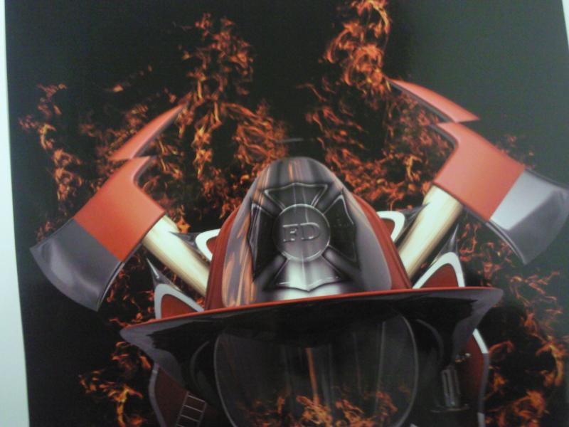

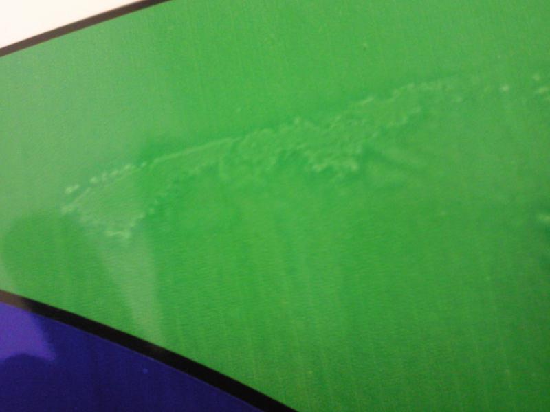

Can you post a couple more pics?

astro8
Change the media and do a head clean and make sure your heaters are working and see what you get...that first pic looks like media contamination and no heat. 3rd pic looks like it has no heat and crap all over it as well
