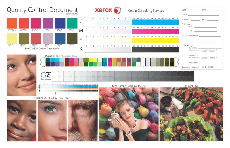

Gray
Every thing about color is based on gray balance if you not print gray in balance you have color cast issues all the time.
Print a 50% K next to a 50c/40m/40y and it should match. If not your not color calibrated. This is the basis for G7 and they just charge you more and make it sound harder.
Here is a test form to see if your printing gray.
Grays are always the toughest to hit, especially three color grays. Any shift in the color balance and the gray will swing to a side other than neutral gray. Calibrate your printer and then create a G7 profile. The G7 process is based upon gray balance...it will make your grays look a lot better and much easier to produce from media to media and printer to printer.
Its not hard to become G7 certified but like anything it costs money. You will need something to read the color like an iOne or i1iSis, and software that helps to make the curve, like Curve3 software. You can read more and get a free P2P color target at www.idealliance.org

First, understand that G7 has nothing...nothing at all to do with large format inkjet printing.
What G7 originally was was a method for calibrating offset presses. In that sense it's about "grey balance" yes, but in a completely different environment.
In very brief, G7 is a method for determining the tone ramps of devices when the white point of the media, the chroma value of each primary, and the density of each primary all comport to G7 standards.
If all those conditions can be met, then it's possible to print to a standard profile, such as SWOP or GRAcol, once you can determine the tone ramps of the device.
But ... once you use a a custom ICC profile, even if you built your linearization (tone ramps) with Curve software, then you're not using G7 anymore. Because it's the profile that tells the printer how to make the dots, not the linearization.
The reason greys are hard is that frankly, while many people make profiles, few people are all that good at it. It's an art that can take years to learn.
And in this business, profiles are everything.
But what happens is, if you're printing, say, a bright, vivid red, if your profiles are off what your printer is printing by 10% or so, you're not going to see it.
If, however, you're printing a grey, then you've got no room for error. By any amount that your profiles are off how your printer actually prints, you'll be off in that direction.
It's all about your profiles, and G7 will not help.
