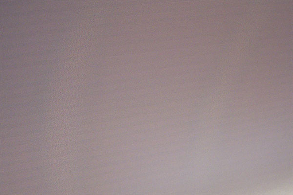

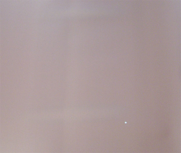

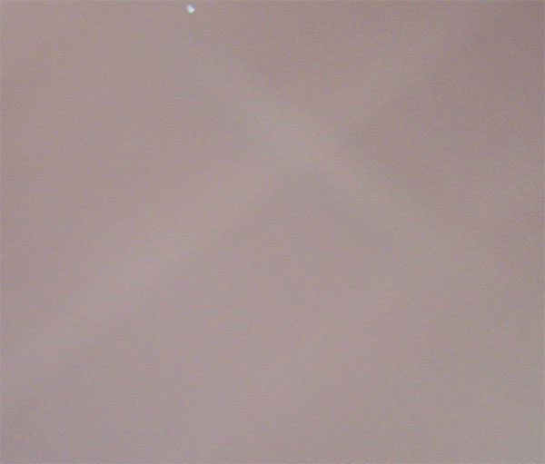

I am having some issues with my printer that are real noticeable when printing solid colors. I have included some sample pictures. I am getting blotchy areas that seem to be sporatic and banding now that seem consistent.
I am using SP540 with versaworks printing on Oracal 3651 matte. Running the print at high speed, print dryer is set to 100 degrees. I have tried standard mode as well and get the same results. I have the Oracal profile for the 3651.
Would anyone have any suggestions on which adjustments need to be made to correct these issues? I would appreciate all comments. I am fairly new at printing and find the forum to be a great resource of information for learning!

I would try doing a test print to see if you have any nozzle dropout.
If you do, there's the banding issue. Printing on high speed will also create more banding. Try doing all the user calibrations. Especially the feed cal.
Make sure those two boxes merry up to each other. Try a 3 " run on standard and see if you have the same problem. please post progress.

To me it looks like a problem with the media. Is it old, or has it been in contact with something. I can't tell for sure, (I am on my laptop and the screen just aint that great) but it seems like the problem could be there before it goes into the printer, and ink is not taking to certain areas.
Feel free to tell me if this is stupid, but it has happened to me.
pineguy2
I am thinking it is something with the media as well, it is getting close to the end of the roll. It isn't that old and hasn't been in contact with anything but one never knows what happens when it is made. I picked up a new roll this afternoon and will try the same print out again. I am using the same settings as I have in the past and have had really good results.
I think I got the banding issues resolved with the feed calibration with this media. I did the test print as I do every so often and it looks really good, no missing bars. I will post again when I try the new roll of media.
