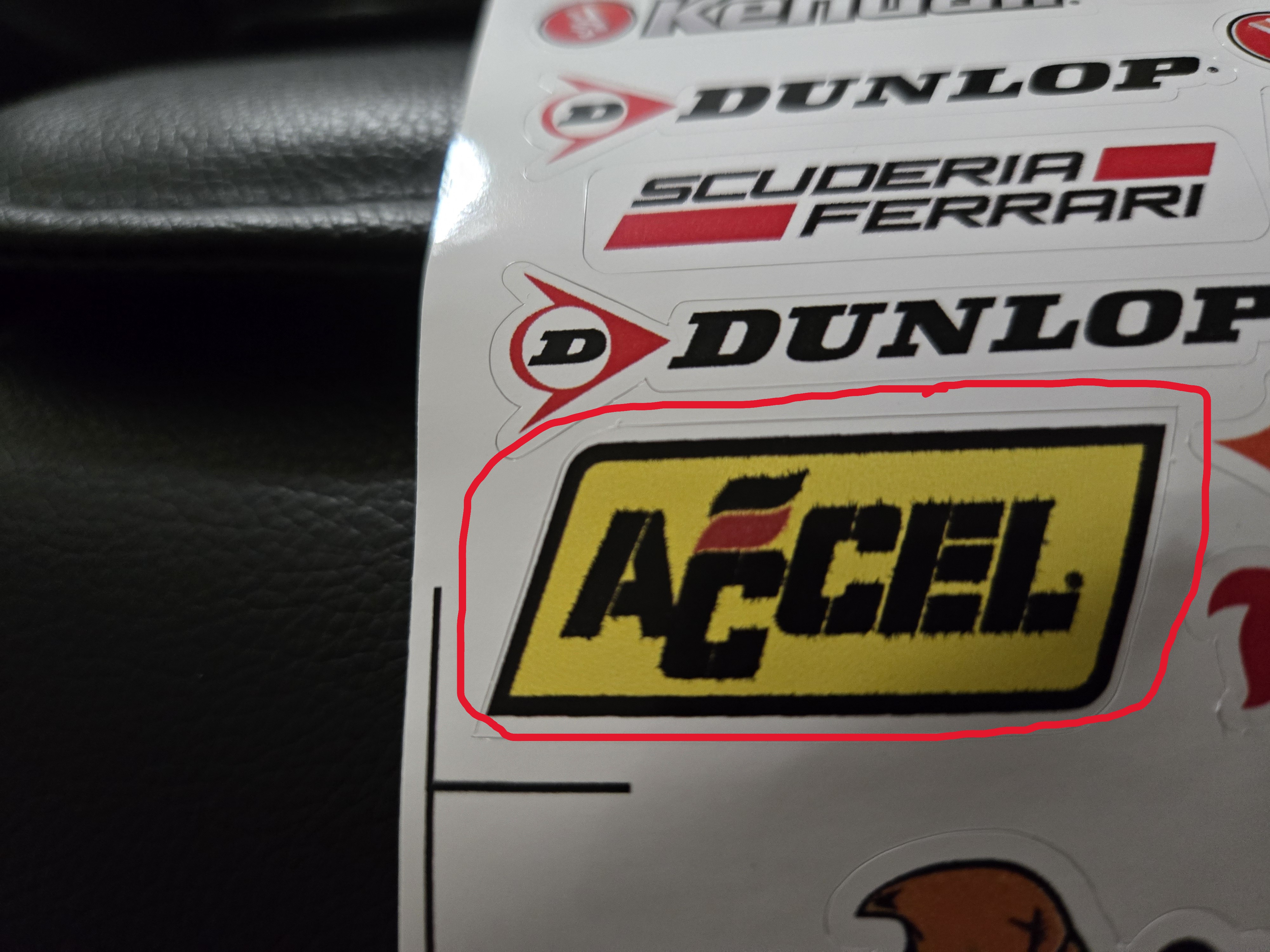

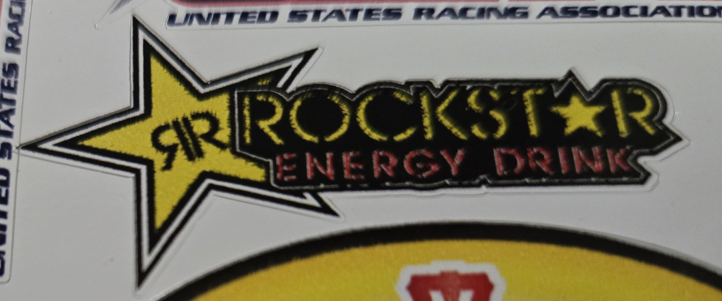

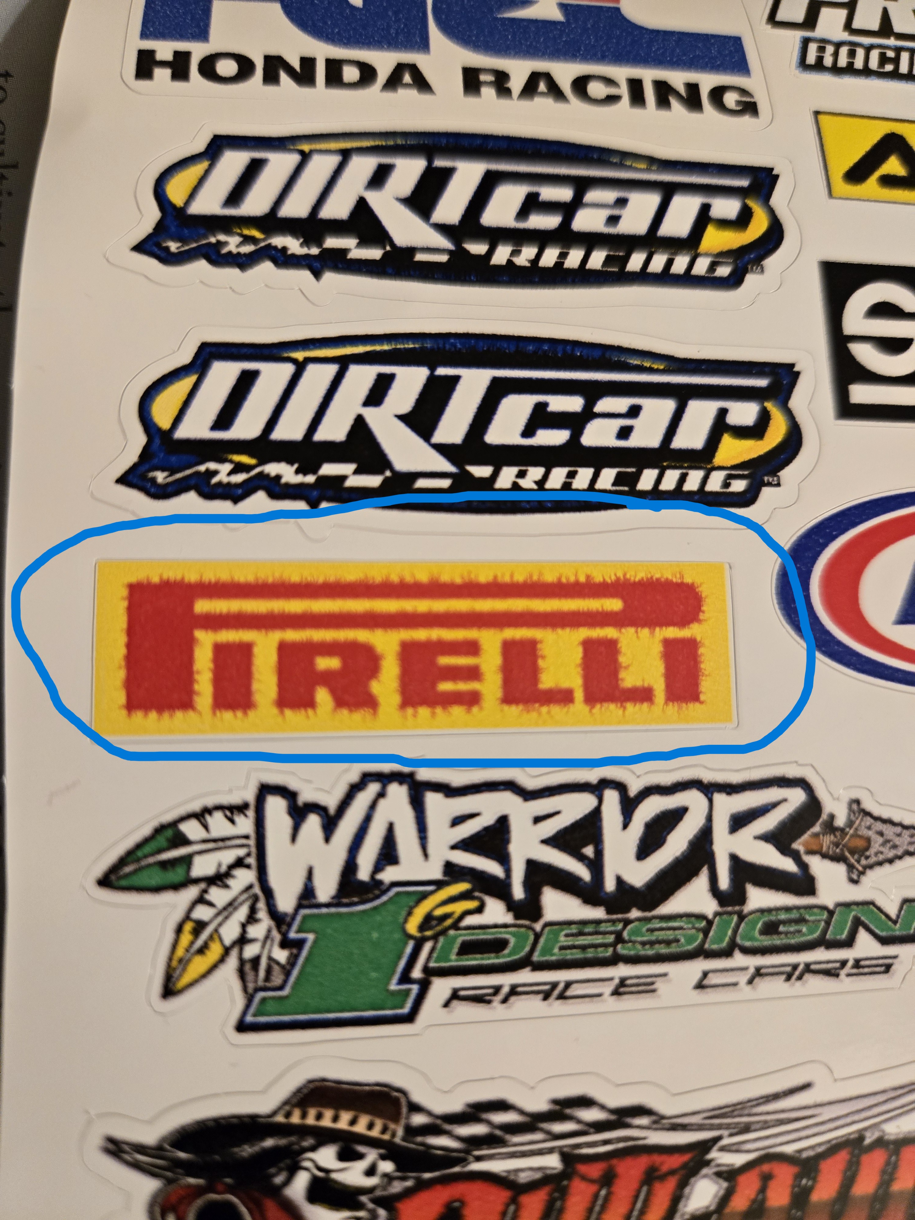

Lately, I've been having issues when printing. (attached pics) Does anyone have an idea of what could be happening?
I usually print different designs per page, and the bleeding doesn't happen in all of them. It mostly happens with yellows, red, and black.
I've recently changed vinyls but did not have a problem printing until recently.

I did try installing a new profile that I downloaded from the HP website, but when that didn't work, I switched back to the old one. I also tested two other profiles. Things improved slightly, but the defects are still there, and they always appear on the exact same stickers in the layout.
jadrewitz
It’s the Optimizer printhead like others mentioned. Had the exact same problem a month ago. Changed the print head and prints perfectly now. ChatGPT helped me troubleshoot the issue.
