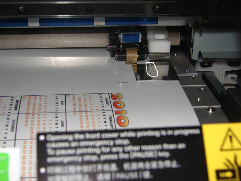

Hey guys, Since getting my printer i haven't done much printing and today i did a 4 foot print and it keeps printing off. The printers about 3 weeks old.
I line up the paper between what's circled in white and still the reg marks and prints print closer to the edge the further it prints.

SS Inc.
The slit in the media holder flaps shoud be right about to the edge of whatever you are printing on (give or take whatever you feel comfortable with...at least that was what I was told). The print area is always within the inside edges of your outermost rollers...

The photo is a photo of it being off track, i usually line the paper up within the small gap (circled in white) on both sides.
I am printing on white 3651 and did a calibration.

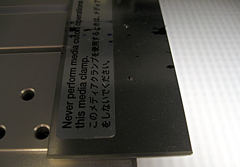

B Snyder
Use the holes in the media clamps to align your media. I just ran 16' of banner material and this is the result. Zero skew. Didn't use the flanges, just unwound material as needed and had the brake off on the rollers.
