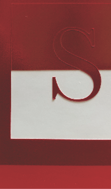

Something I do from time to time is to print onto color vinyl, for example:
I have a local college that needs some vehicle door vinyl that has small copy with thin strokes,
very hard to weed and not clean looking on printed and laminated white vinyl.
What I do is use cut vinyl that is the closest color I have; in this case their copy is burgundy so
I used dark red. I print a gradient numbered bar (image below) from nothing to their color and find the spot that looks best.
The color is much more even and it's so much easier to weed.
I don't laminate because if the vinyl were to be scratched, or the ink fade, the dark red will blend in.
This wouldn't be practical with a logo with many different colors, but in this case it works great.

how
So how do you do the gradient number bar? I just had a client come in and wanted a decal to match the color of his seats on his golf cart. I did a random color selection based on another decal he brought me. I wanted a more standard way of doing it other than "let me pick this one and move my color over a little on the spectrum for 3-4 prints".

Andy D
The colored vinyl is ij35?
No, that's the printable white vinyl I first did the door vinyl on and wasn't happy with the finish or the cut.
On the red that I printed burgundy, you would think it was burgundy cut vinyl.
