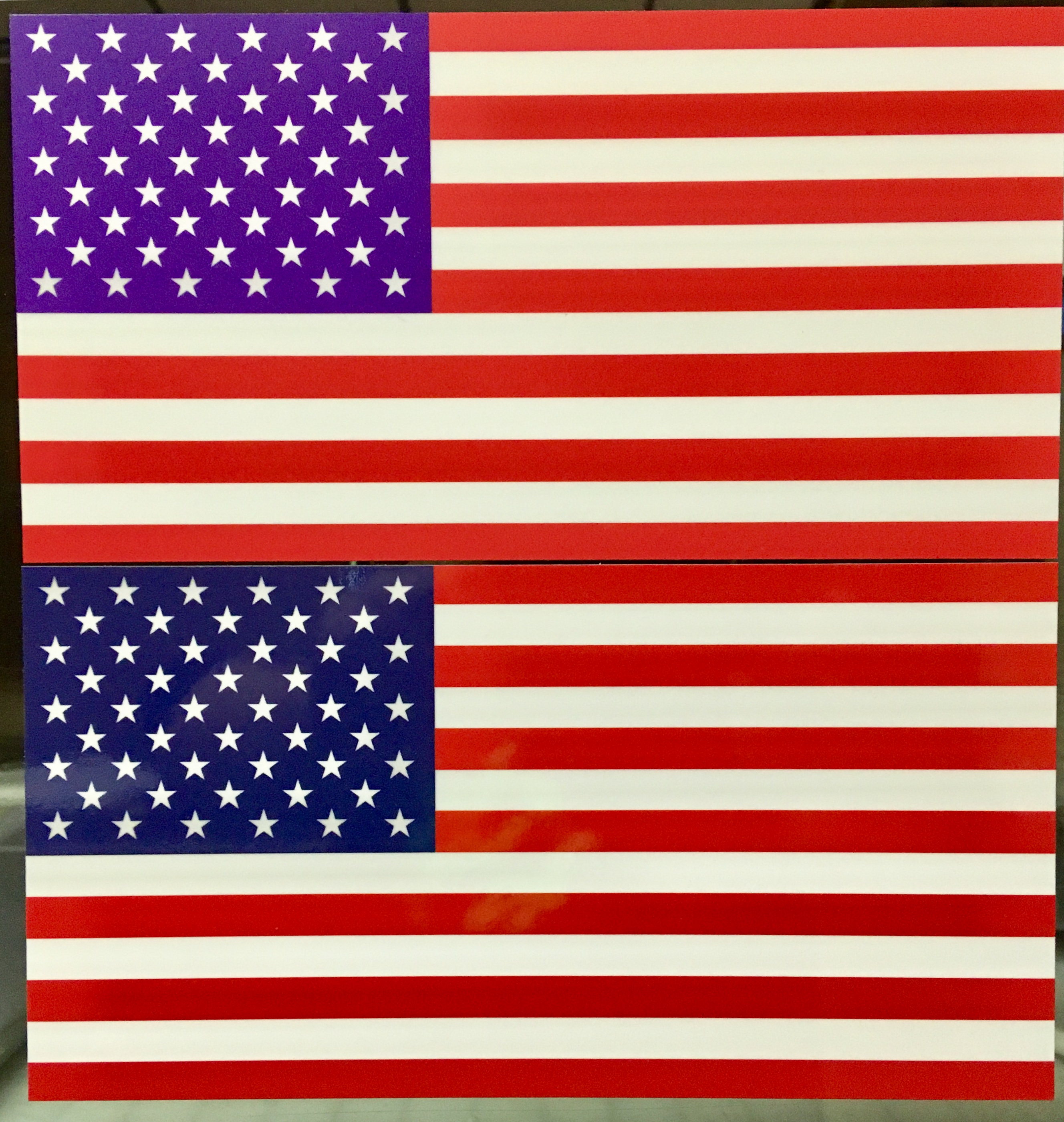

Here is a side by side comparison of a generic HP profile compared with a custom profile. Both used the same linearization. Ink limits and splits are per profile. Notice the orange looking red and lavender looking blue in the top generic profile. Lesson to be taken away is that you will be better served creating your own profiles.
