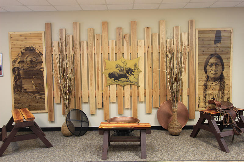

I think if you played around with it you could come up with some cool effects.
I've been playing around with printing to 1/4" birch (I think it was birch... started tinkering a few months back then got busy) and it prints beautifully.
I was printing pictures mind you but the ink creates really neat effects mixed with the grain.
Not really on topic (dang I'm hijacking my own thread) But I just thought of this, it's where I used to work, I always liked how it printed....

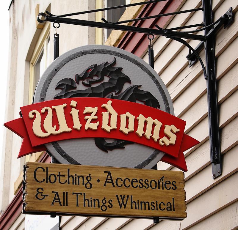

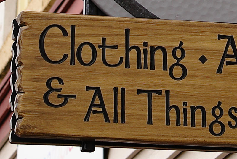

signmeup
This sign is HDU that I "grained" with a fat brush and some runny brown paint. The panel was a pastel mustardy colour base coat. The black lettering is V carved.
Adrian
DigitalWoodGFX
This is actually something we do on a regular basis. I run a couple of flatbed printers in a millworks factory. A lot of the jobs we do call for expensive or exotic woods, so we print on veneer, MDF, birch, or other cheap wood we have readily available. As long as the scans/photos of the wood we're printing are high enough quality, they look awesome.
