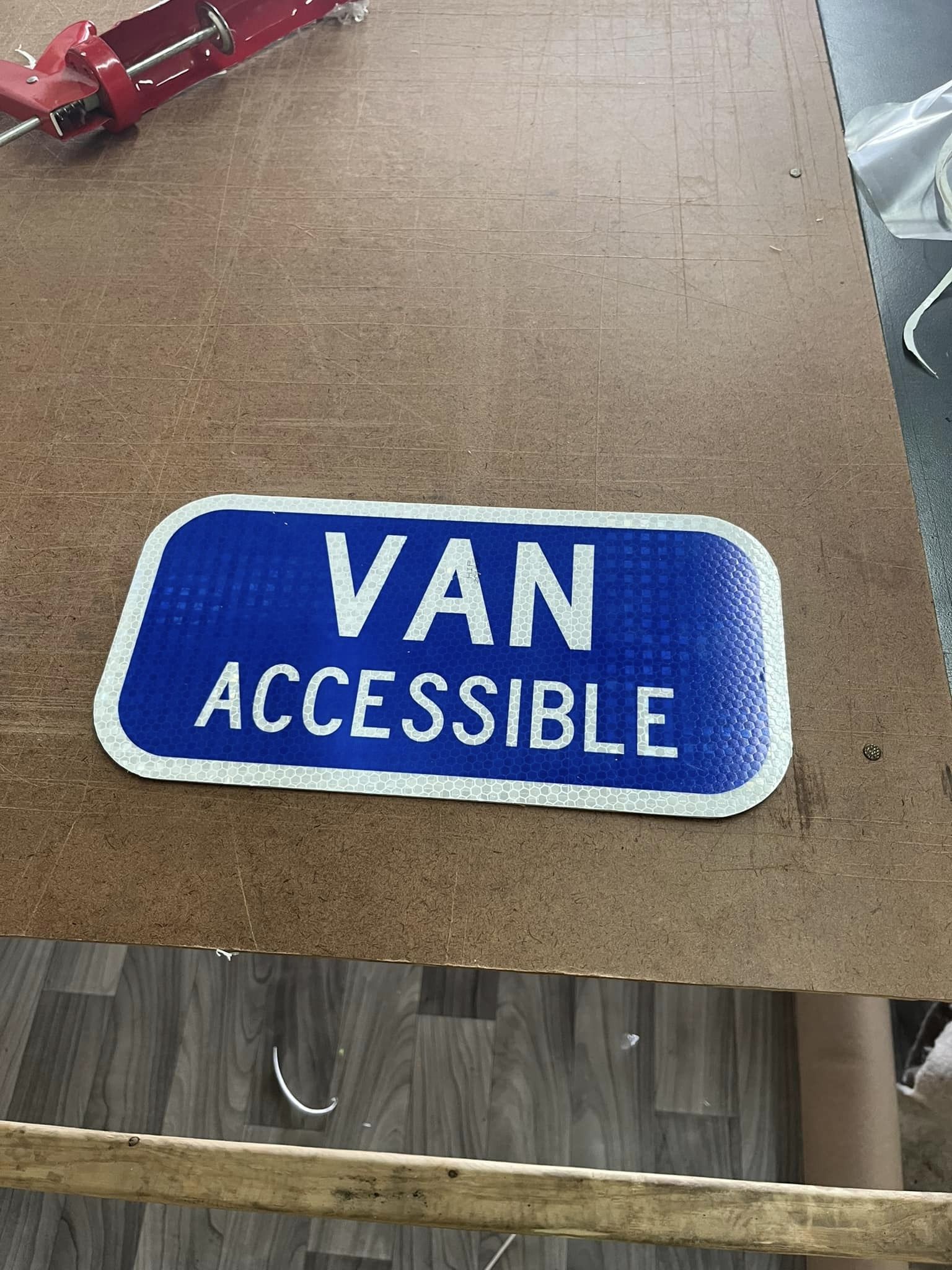

Hi,
I am having trouble with my Roland TruVis VG3-540. I am printing on Avery Dennison T-6500 White High Intensity Prismatic and the prints are not making it translucent and cannot see the reflective. Is there a way to make the reflective translucent when printing on Roland? And does VersaWorks have something that can make the print translucent on Reflective like Avery Dennison?

You will see it when light hits it, in the dark. It is very hard inside to see the effect of any printed reflective material, but it is there. Look at your pic and you can see the shapes. It isn't something you can shine a light onto directly in a see it. Wait until dark and take it outside and set it down somewhere then go away a distance and shine light in its general direction. I think it will surprise you

You can even see it reflecting in the picture..........not much else you can ask from a printed reflective sign.
Solvent ink is not opaque, so the reflective properties will still behave as intended when that sample is hit by a light source.

go stand in a low light / dark room and take a picture with the flash on of the sign

Make sure you are printing with a reflective profile. The profile will lay down less ink than your normal profiles. Also, blue is a tough reflective color in general. I also agree with the others, its probably fine.
