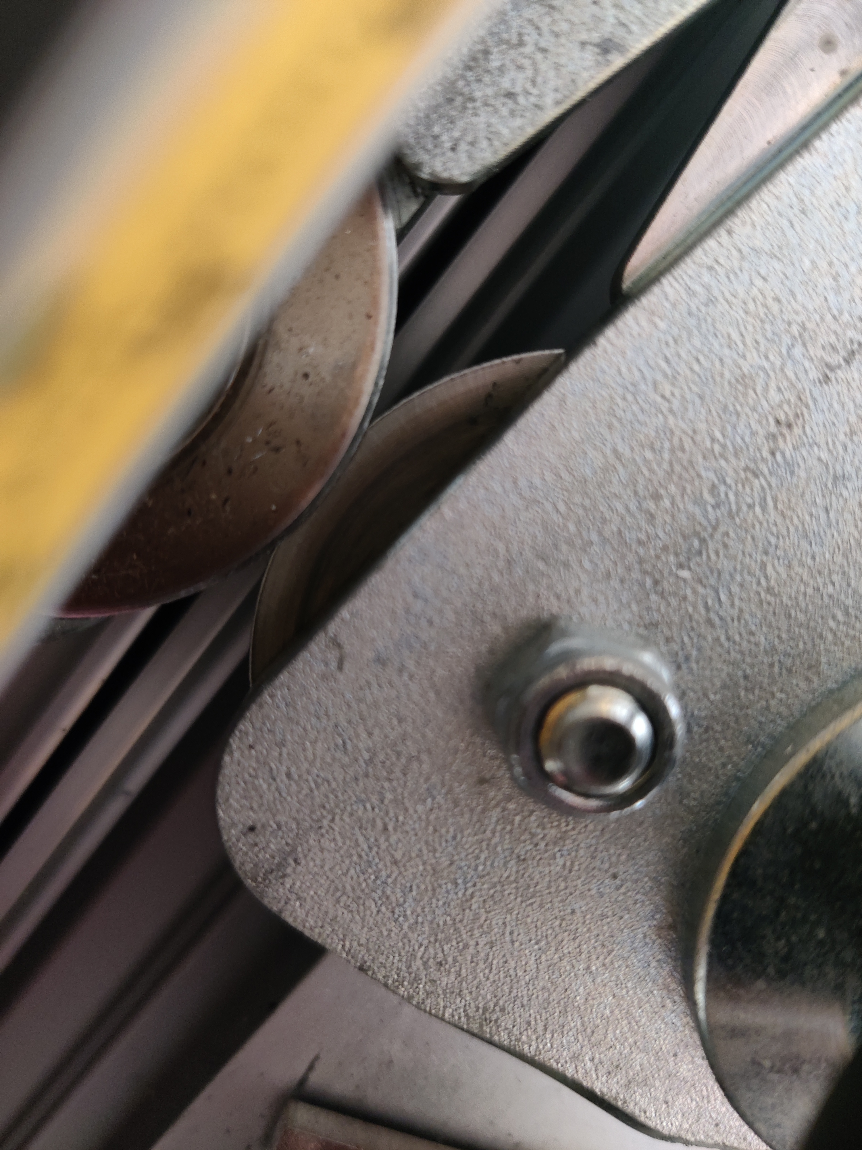

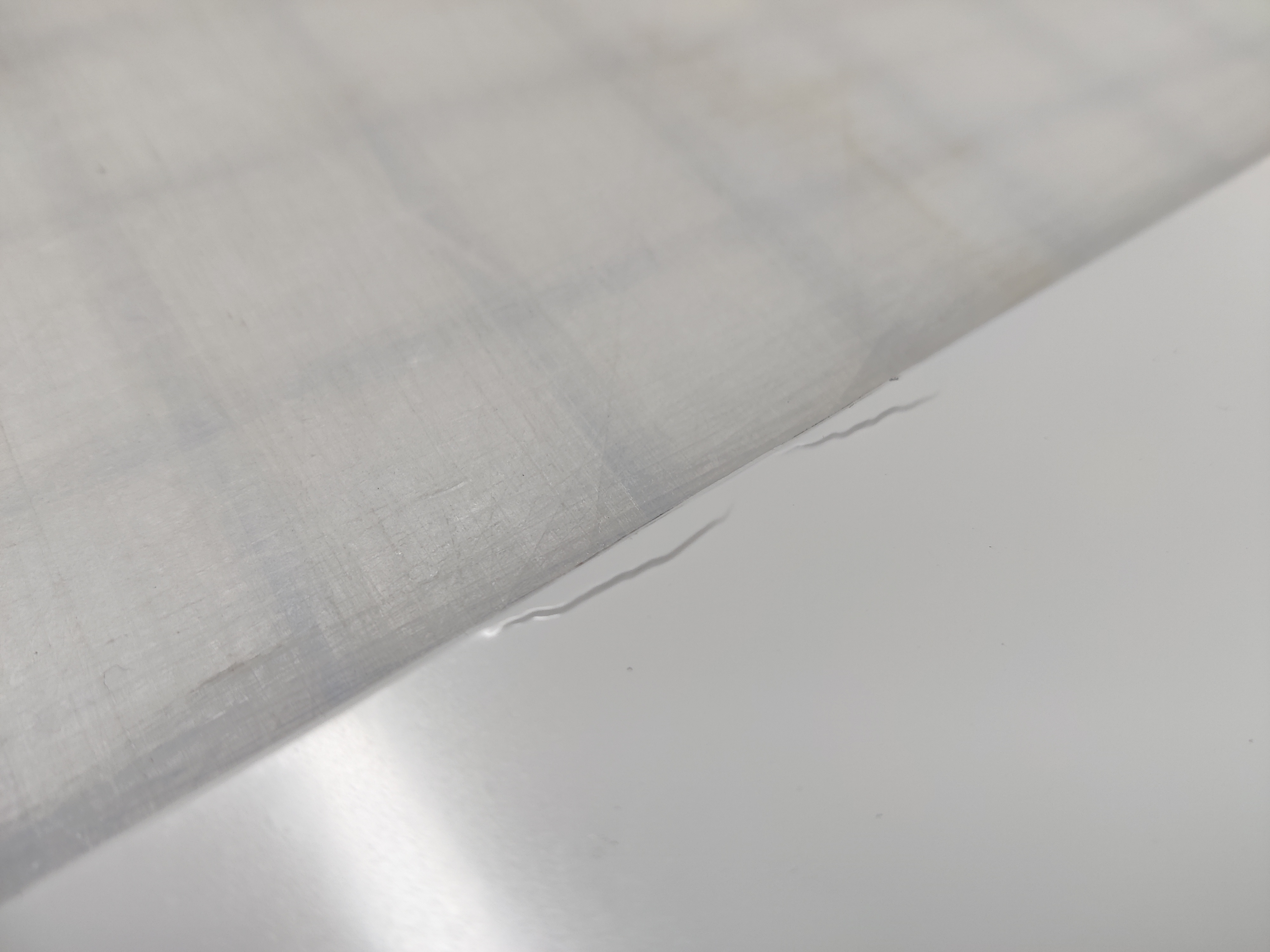

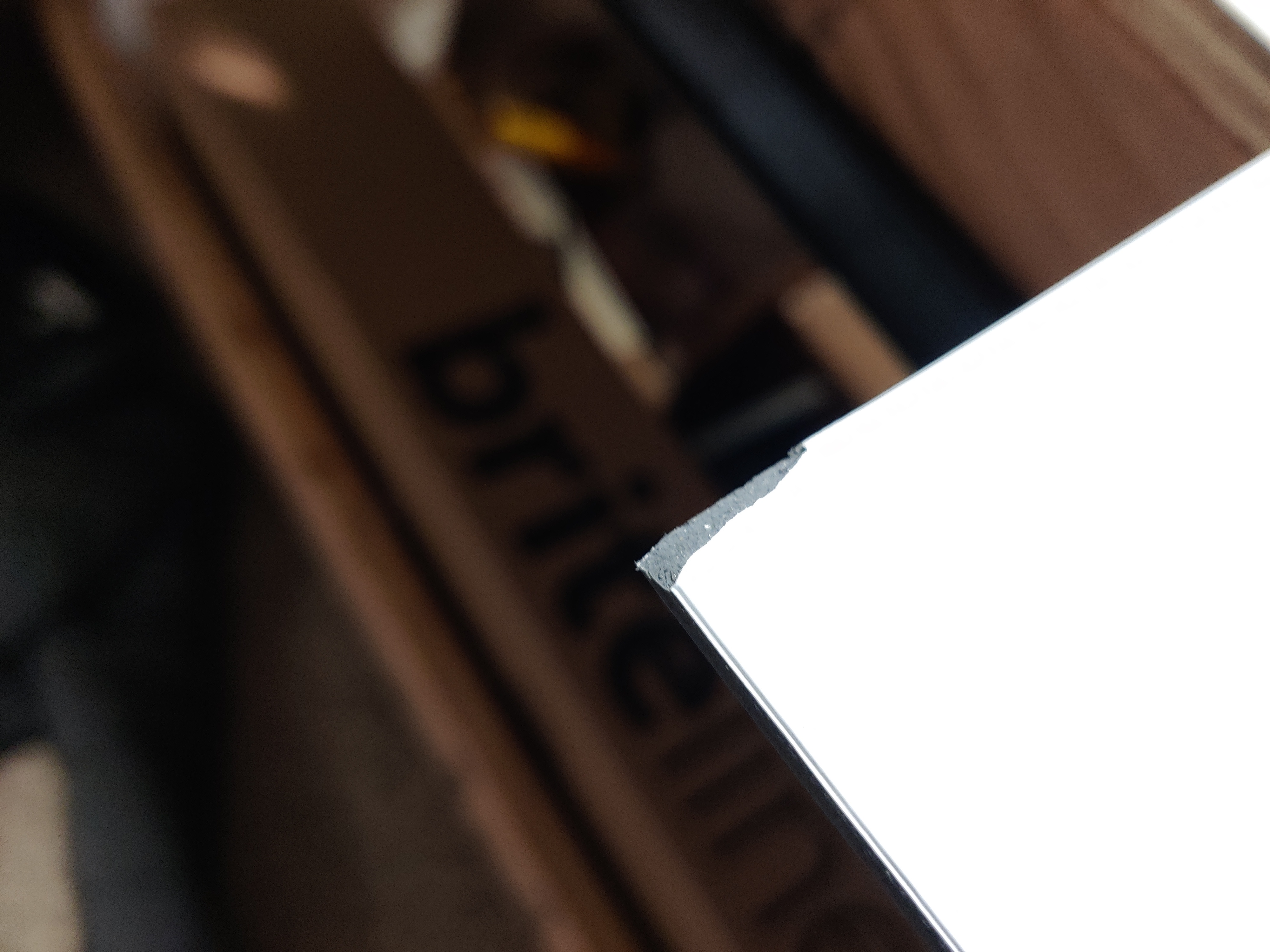

Suddenly my wall cutter wants to ruin every piece of ACM I cut on it. Something is out of whack and I don't know what. I have tried with two cutting heads, one of them the C2 cutting head which is only about a year old. The blades seem to want to lift the ACM before cutting it, causing this terrible problem along the cut edge, plus it wants to tear it right at the very bottom instead of cutting through. Something is clearly misaligned, but I have checked everything that I know to check, no screws seem to be loose or anything.
Anyone have experience with this issue? Any suggestions would be so appreciated.

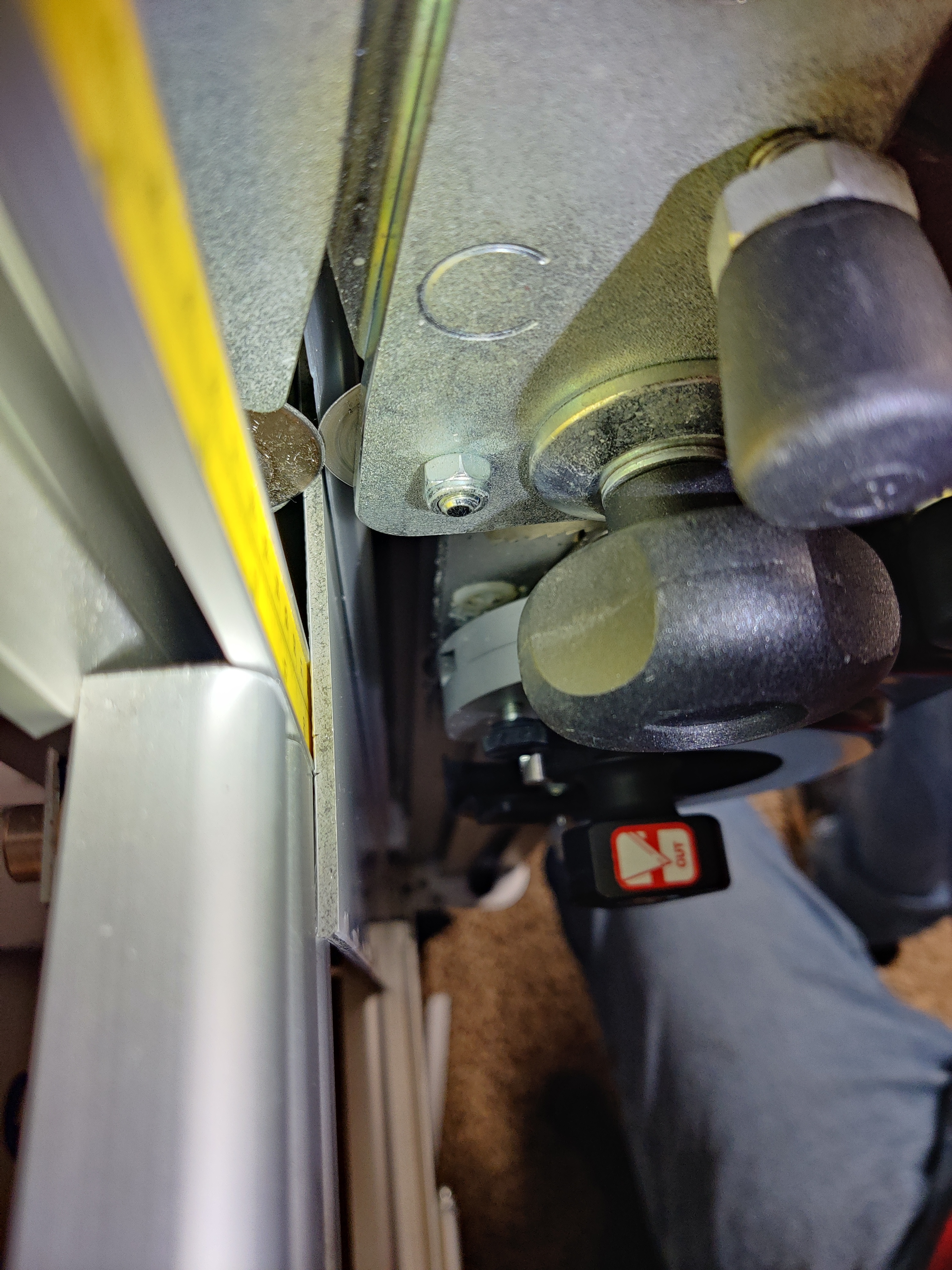

Edit: I added the last two photos to show how the cutting blades seem to be too far back, causing the blade to lift the panel before cutting. Everything seems to be nice and tight, though, so it is as if the entire thing has somehow been pulled away from the cutting plane about 1/8" or so. I'm at a loss.

I've not seen this in over a decade of using a SteelTrak, and yes, something looks out of alignment. How is the depth on the regular cutting head looking? If this is also standing too far forward, then ISTR there are bolts top and bottom of the main body that may not be snug.
Might be worth checking the guide wheel adjustment. https://www.keencut.com/wp-content/uploads/SteelTrak-250-Instruction-Manual.pdf section 7.13

Thanks for the suggestions. Unfortunately, I'd already checked the bolts that secure the rail - all snug - and I tried your other suggestion. Nothing works.

Mine brings the ACM forward by less than 1mm - the C2 cutter actually rotates very slightly clockwise (viewed from left) when starting to cut, and I think it always has done.
Have you checked the bump stop at the bottom of the carriage is all the way down - I could see how it being slightly unscrewed might lead to tearing at the base.
Acrylic is scoring, and coroplast is just the knife going through, so shouldn't have put a particularly high torque on the machine.
If you've managed to deal with the squaring and clamping issues, and you've been able to cut fine in the past, then I'd think that the main body isn't out of true.
