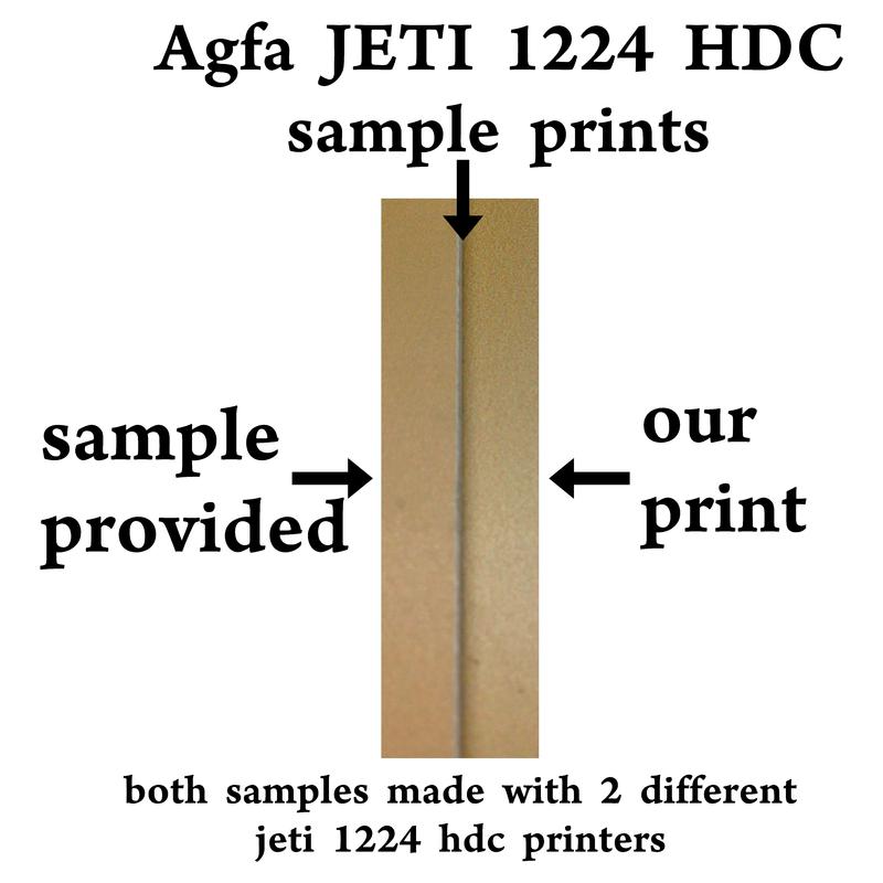

I bought an Agfa jeti 1224 HDC printer couple of months ago and I am still in the process of testing it to it's full potential.
I encountered a problem that I can't solve, maybe you can help me :
When I try printing light pantone colors (on any material: coroplast, foam, aluminum,etc) the print comes out with "noise" (small little white dots).
I went to another company who has the exact same machine and uses onyx and I made a sample ...
I attached to this thread the 2 samples that i printed .... on the left side is the sample I made at another company and on the right side is the sample I printed in our shop ... you can clearly see the difference.
I am thinking it's something to do with the onyx ... but I can't figure out what exactly ...I made tests with our profiles, made new profiles, I bought an i1 to color match .... same result (light pantone colors have small white dots ..)
Can somebody help me please ....
P.S. - Full solid colors like black, red, yellow, etc come out just fine.

From what I'm seeing in your images, I'd guess the problem is most likely profile-related.
Remember that what any RIP does is to convert pixel information into dot information using information provided in profiles. And it is certainly possible to create or alleviate graininess issues in creating profiles. Particularly in Onyx.
And keep in mind the fact that you made new profiles and it didn't solve the problem could very likely mean that in creating new profiles, you just didn't address whatever issue is causing the problem.
If it isn't profiles, then my second guess would be that what you're seeing is graininess caused by some kind of printhead alignment issue.

I don't see white on top of colors. If the profile is the same as the other customer, it is either an alignment issue (80%), or head and temperature issue.

Is the difference in the droplet size (variable)? To me the smaller the dot the smoother the print. It appears to be a larger droplet being printed on the right. We had a problem like this occur years back on a roll to roll machine. It happened when our rip/software was updated and caused an increase in the dot size. We ended up reverting back to the older software for a higher quality print. I may be crazy, but its a thought.

I think the graininess in your samples comes from the profile. Your profiles were created onsite or you just got generic profiles from the printer/ink supplier? Sometimes you need to play with drop sizes in profiles to remove such artefacts.
Check also, if Onyx allow to print without one hardware colour? Maybe you could trace, which channel creates the problem.

I'm curious to know if you printed it unidirectional if the problem goes away?
I'd be interested in the profile the other company uses to see if it compares to the ones I have.
Because if they figured out how to make it print in grayscale/varyiable dot mode, I would be very interested.
