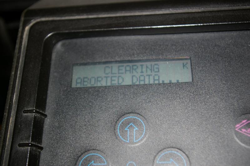

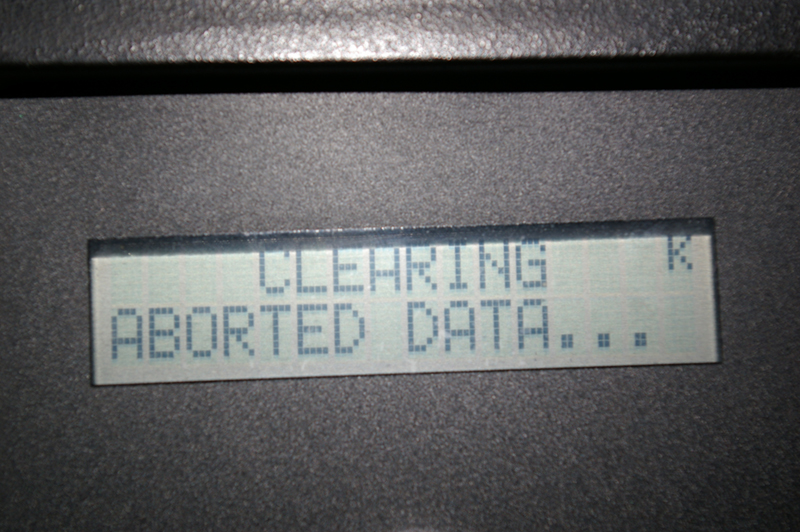

Hi out there! I hope someone can help.... i hade a fine working cutter until yesterday. I use flexisign and the cutter is connect to a USB converter (from serielport on the cutter to seriel/usb converter to the pc. I did not change anything on my pc or software/hardware. When i execute a job its shows that it cut in flexisign but the cutter dont respond. I get only on the cutter screen this text " CLEARING ABORTED DATA....". iS THERE ANYONE OUT THERWHO CAN HELP? I also try to install summa cutter software and driver. When i try to connect to the cutter it says check the cable the cutter in no connect. i have try with other cable and its samme error i get. I use the right com port and i checked all things.

I tryed to uninstall the driver and also change the com port but it says the same: clearing aborted data. Its seems that the problem is on the cutter. Is there no function so i can delete or reset the cutter?

If you power the cutter and the computer off, restart the computer, clear the cache, then power back up the cutter. The cutter's internal memory is (or should be) automatically wiped each time it's powered down then back up. Make sure there are no jobs in the queue in Flexi before you power back up the cutter - Flexi may be trying to send tons of old data (hence clearing the computer cache). After you do all that and power back up the cutter and still receive that error message, then yes, there is something wrong with the cutter, maybe a bad board. If that happens email Summa with this thread and see if they have a suggestion.

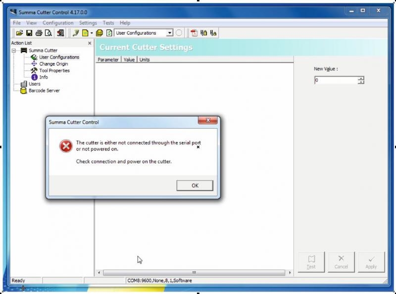

I also try with summa cutter software and get this error

I have try to connect by the SUMMA Cutter control, but as i put a screen of the result i can not connect to the cutter (see picture above).....

You don't have your ports configured correctly. Unplug everything off the cutter, including the power cord. Wait 5 minutes, then plug the power cord back in. Turn the cutter on and tell us what the screen says. If the cutter itself is ok, you'll get your normal startup screen.
If that works, turn the cutter back off, plug the serial cable back in and turn the cutter back on. Usually your computer will say something like 'detecting new hardware' or some such. If you still can't send from Flexi or the Summa software and get the same error that the cutter isn't connected, you'll have to start digging into your port settings. Open up your control panel and get to the hardware connections section. Look for any ports that are showing as an error. On my system, using Windows7, the serial cable and usb convertor show as 'Gigaware Serial to USB cable' - which is the maker of the convertor. My cutter is currently off, but my system still recognizes the USB. Are you entirely sure that every cable is connected and tight? Did you accidentally maybe move something that could have bumped a connection?

I unplug everything off the cutter include the power cable. I wait 3-4 hours and then turn the cutter on, without connect the seriel cable. I just turn the power on and the display says "Clearing arborted data" :banghead:
letterman7
:doh: Oh boy... sounds like the mainboard on the cutter died. Call Summa to confirm. Might be cheaper to purchase another cutter than replace the board depending on how old your machine is. Good luck.

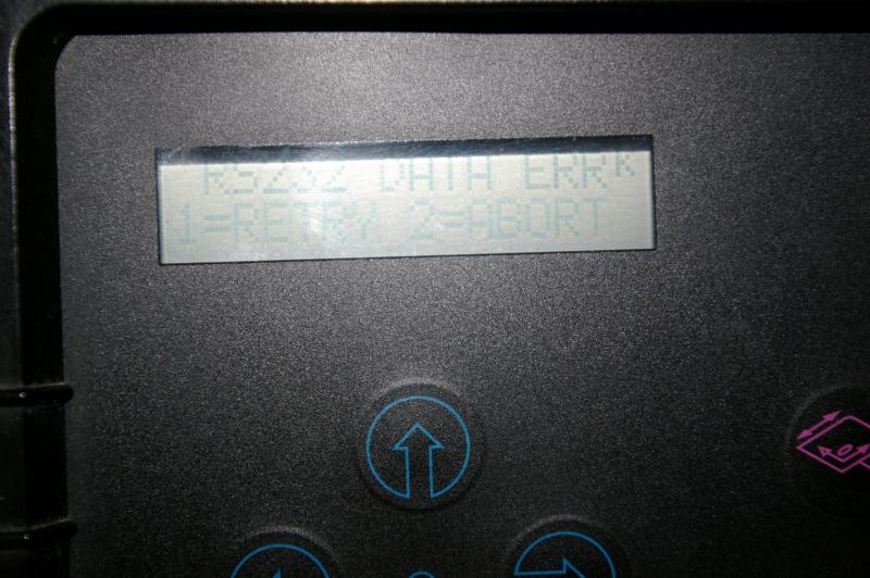

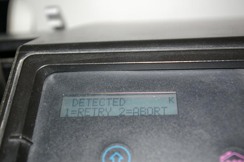

After i try a 1000 things i try a RS232 test on the cutter. Now the error "Clearing arborted data" is changed with " RS232 data error detected" and its allow me on the screen to choose two things. 1: clearing arborted data and 2: to abort. When i press 1 it come up with the text clearing arborted data and after 20 seconds it come with 5-7 bip (sounds) and get back to the options 1 or 2. Nothing else from the display are possible to pres..............

round man
just a thought here but did you check device manager to see if windows has reassigned the adapter to a different port? it will do that sometimes and it'll really screw things up,....sometimes it will show this as a port not found in your cutting software,...sometimes it will not
