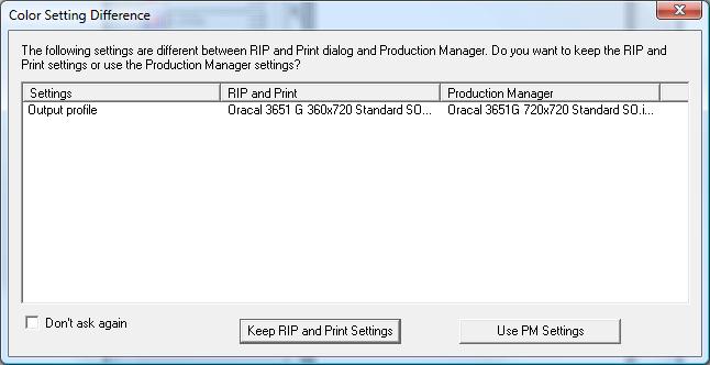

However, I was referring to maintaining your workflow in RIP & Print and change the Default Job Properties, DJP, in PM. As you have probably noticed, once you select RIP & Print, PM launches. The information that populates this dialog can either be from previous jobs you have completed (as you have experienced), or from PM itself. You may have even seen an additional window that appears at first launch which enables you to select between both RIP and Print settings and the PM ones... see screenshot. By fine tuning the DJP in PM, you can utilize the "Use PM Settings" button and not run into the individual job interference on future jobs.

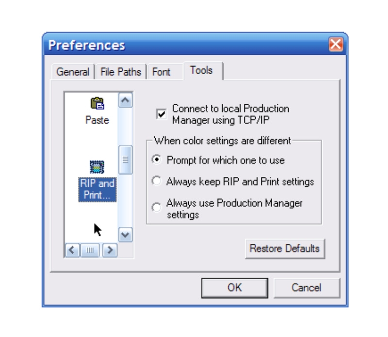

If you click on edit, then preferences then click on the tools tab. Use the scroll window to find "RIP and Print" and click on it then select "Always use Production Manager settings". In the PM you can have your different profiles setup for what your are working on. Hope this helps.

I use 7.6 and in the preferences you can choose if you want to be notified when the color settings are different in your saved file and what is in PM.

I think he wants to be able to keep all the settings the same as the last time that file was printed. Example: You boost the cyan a little and cut the magenta in the rip and print dialouge box. And I think but I'm not sure that if you select the the preference the way the picture shows in above post, you can do that. When you click on Rip and Print a box pops up asking which setting you want to use and then it displays the rip and Print settings and your PM setting side by side.
I'm not sure how much of that info is saved with the file for later use though.
Arstron
I dont think that option will save the information from rip and print into production manager, I was thinking the same thing in my post earlier, until I tested it, I then rewrote my post.
