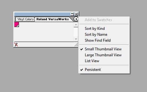

Awesome thanks guys worked like a charm. Kind of an unrelated question but how do I get Illustrator to save my swatches. I set up a CutContour swatch and every time I close and reopen the program it isn't there.
Malkin
Click the little arrow, then choose "Persistent"
It will then stay.
