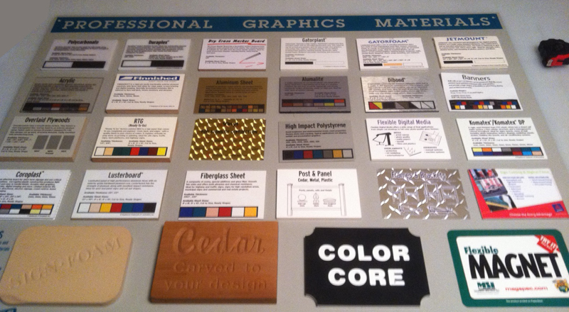

Sign_Boy
How will these signs be used?
MDO or RTG may not be the best solution.
Have you checked with your local supplier to see if they have a board similar to this one?
It will help you to learn about some of the materials used in the biz.
