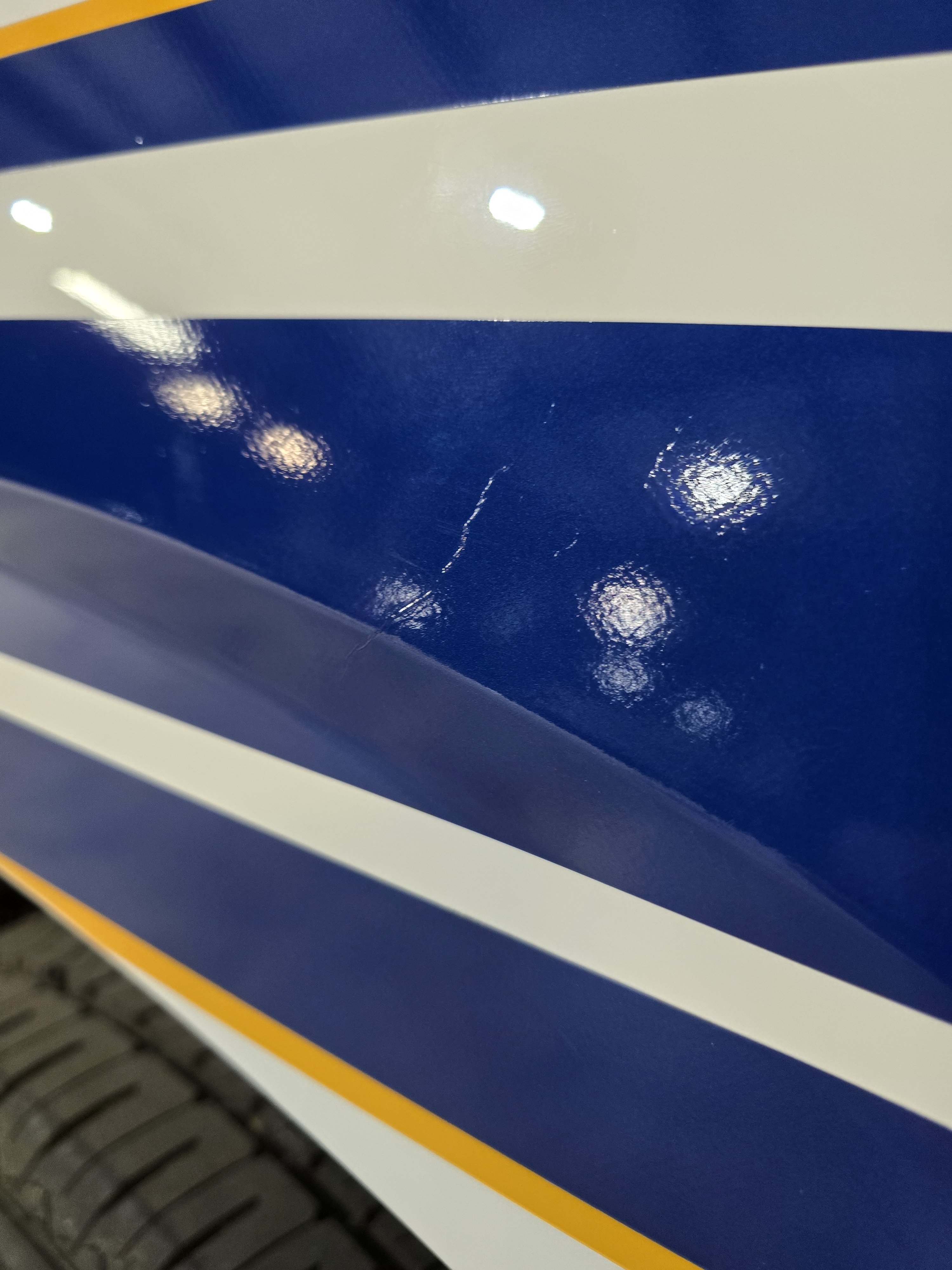

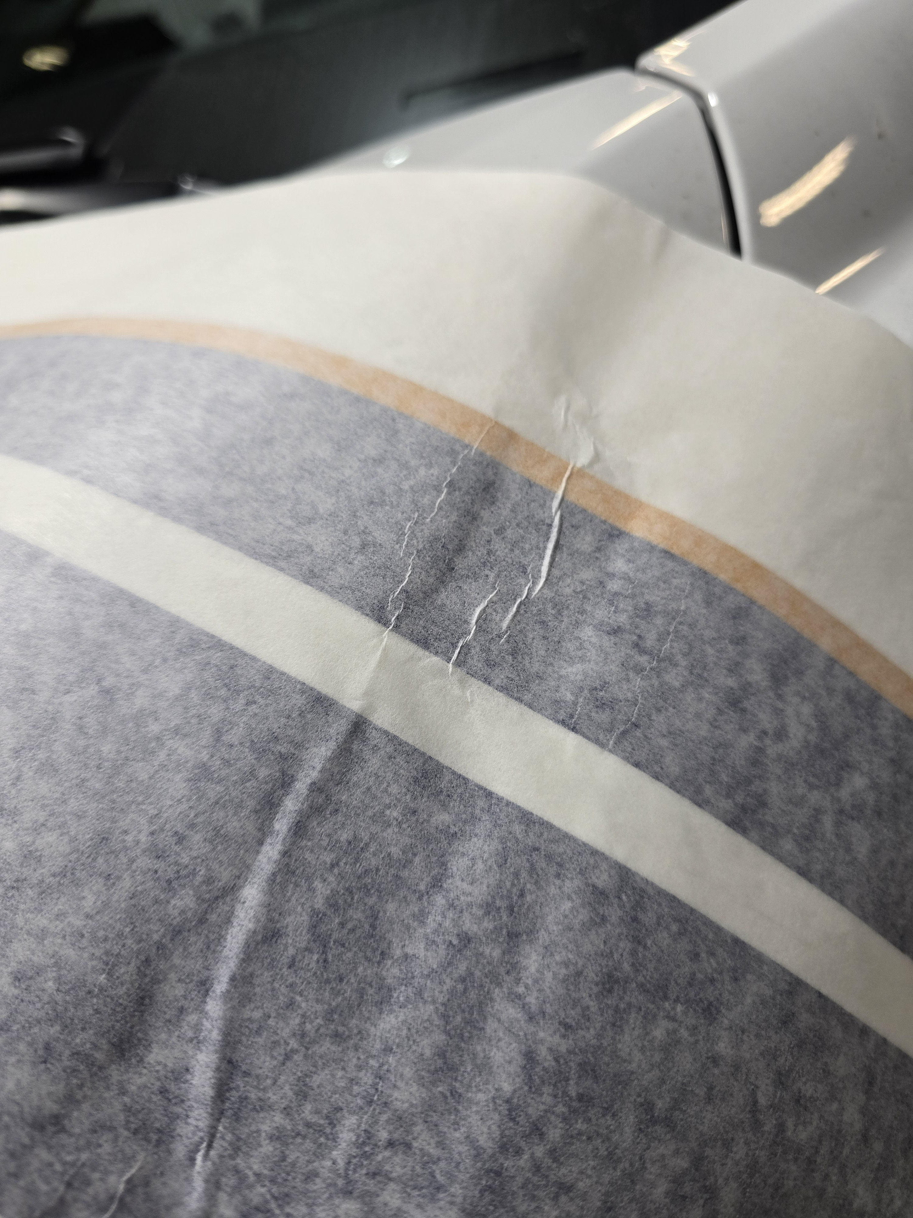

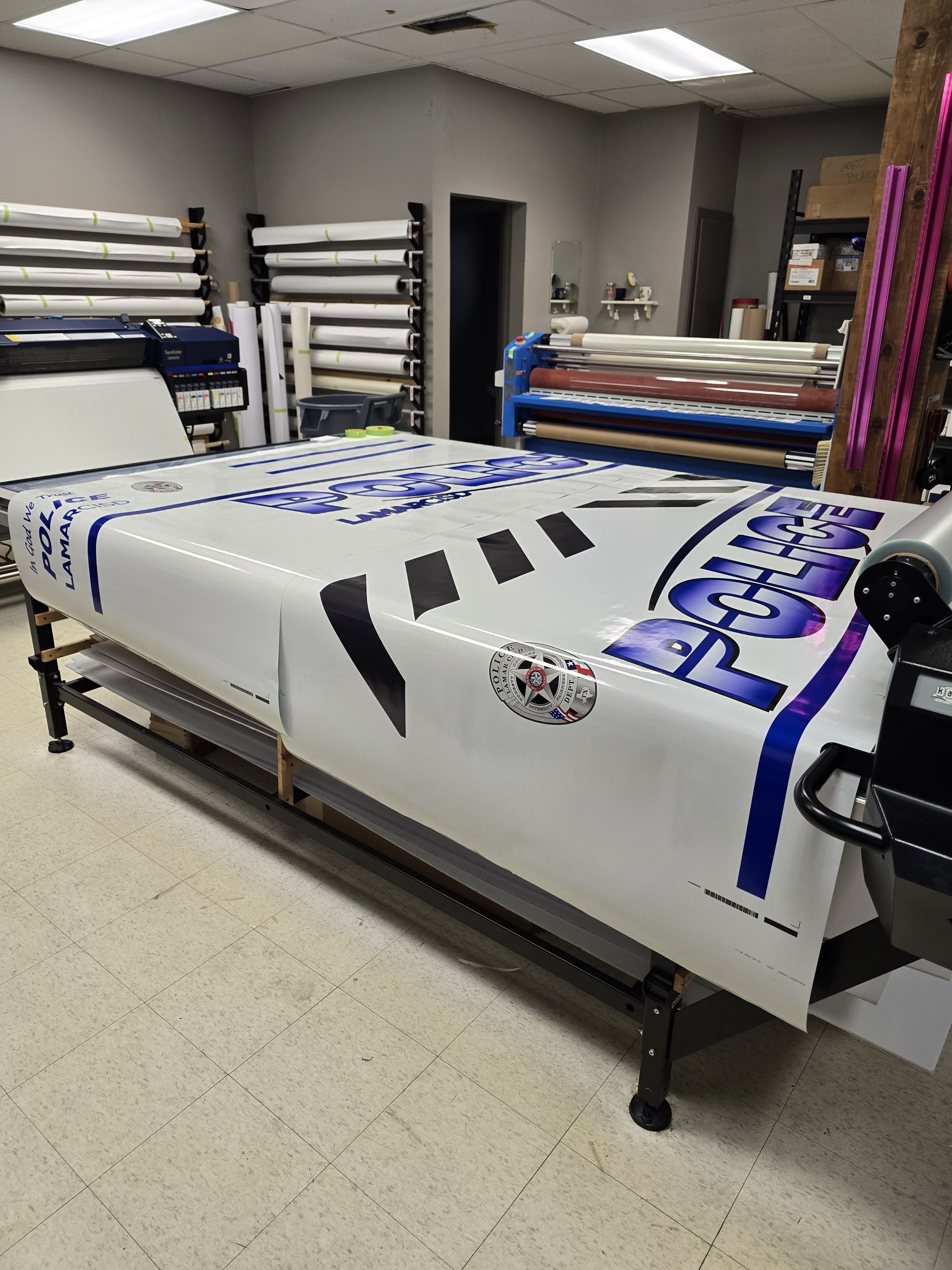

Our current process - Production will print a 48in wide sheet that has the printed graphics, laminate, cut on the Graphtec, weed the excess, mask the 48in sheet using RTape masking, roll loosely print side out, put inside an old vinyl box. What I have found is that the graphics get flattened inside the box and during transport, causing tunneling issues. I've also noticed some masking rolling and sticking to itself, causing issues during installs. When the vinyl/masking flattens it creates (what appears to be) stretch marks that won't go away in the printed vinyl (see pics attached). Not sure if this is cracked ink or what.
