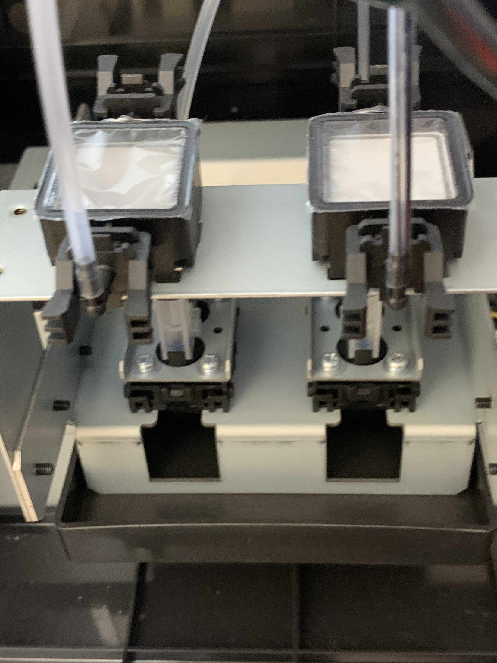

I have a CJV150 printer, and I noticed that the "Supply Pump Assy" is shown in the mechanical drawing Rev 3.6. However, I am unsure about its exact purpose. Could anyone explain what this component does in the printer?
Any clarification would be very helpful. Thank you!
hybriddesign
owner Hybrid Design
Yup, as Smoke Jaguar mentioned it's only used if you have white ink installed. If you don't it doesn't do anything.
Marcos Duque
Got it! I bought my CJV150 used, and it’s set to CMYK by default, which I’ve been using. After replacing the dampers, I noticed there are two extra connectors that go to the back of the printer. I thought they might be used for some procedure related to damper refilling or charging.
Smoke_Jaguar
They are also to recirculate the white ink, and pretty common to see 4-color setups on these. Very capable and quick in dual CMYK mode. Moreso if you have a CJV/JV300 with the dual heads.
