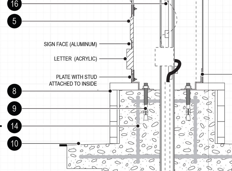

Rick
Are the letters white? or will have a transparent film.
There are a few ways, but I prefer routing out the letters
as this holds up better than gluing individual letters.
If you have clear or trans white letters and use a clear
backer, you SHOULD use a trans white film behind it to
avoid light leaks.
I always call out a mechanical attachment, (see drawing)
and maybe a dap of silicone in certain areas to keep it from
rattling. I like to be able to maintain the sign face... i.e. graffiti
can ruin both the sign face and the letters if you permanently
attach your letters/backer, you make them removable, you
can salvage both.
