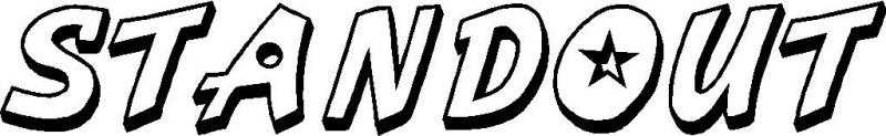

Are you trying to accomplish this?
oarie
Essentially, yes. If the background in your photo was a different color than the inner part of the text it would stand out better. Say the background was yellow, the text outline was black (as it is in your example ) and the text inside was white (again as it is in your example) then the inside of the circle in the letter "A" and the inside of the star in the letter "O" as well as the inside of the "D" would be yellow like the background.

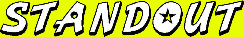

oarie
Based off of your example, this is what I'm trying to do.

Creative_Lance
Ok,
uncompounded your text >> get rid of your shadow>> insert your objects (holes, stars or whatever) >> select everything>> compound then go to Effects>>shadow>> Block (next one down in the list)>>choose the first one and play with the values as you compare it to the original shadow on your text then click on the check mark to apply the effect>>> separate shadow>>select the upper text layer>> use your color.
...you're done!

signguy95
most likely you will need to make a copy of the parts that need to be yellow, and cut them out of the black and then out of the white.
or just cut them out of yellow vinyl and apply after words
Jay
John L
Make a copy of the whoile thing. Delete the vectors that you dont want to be colored. re-Compound again and place it where you want it on the original.
