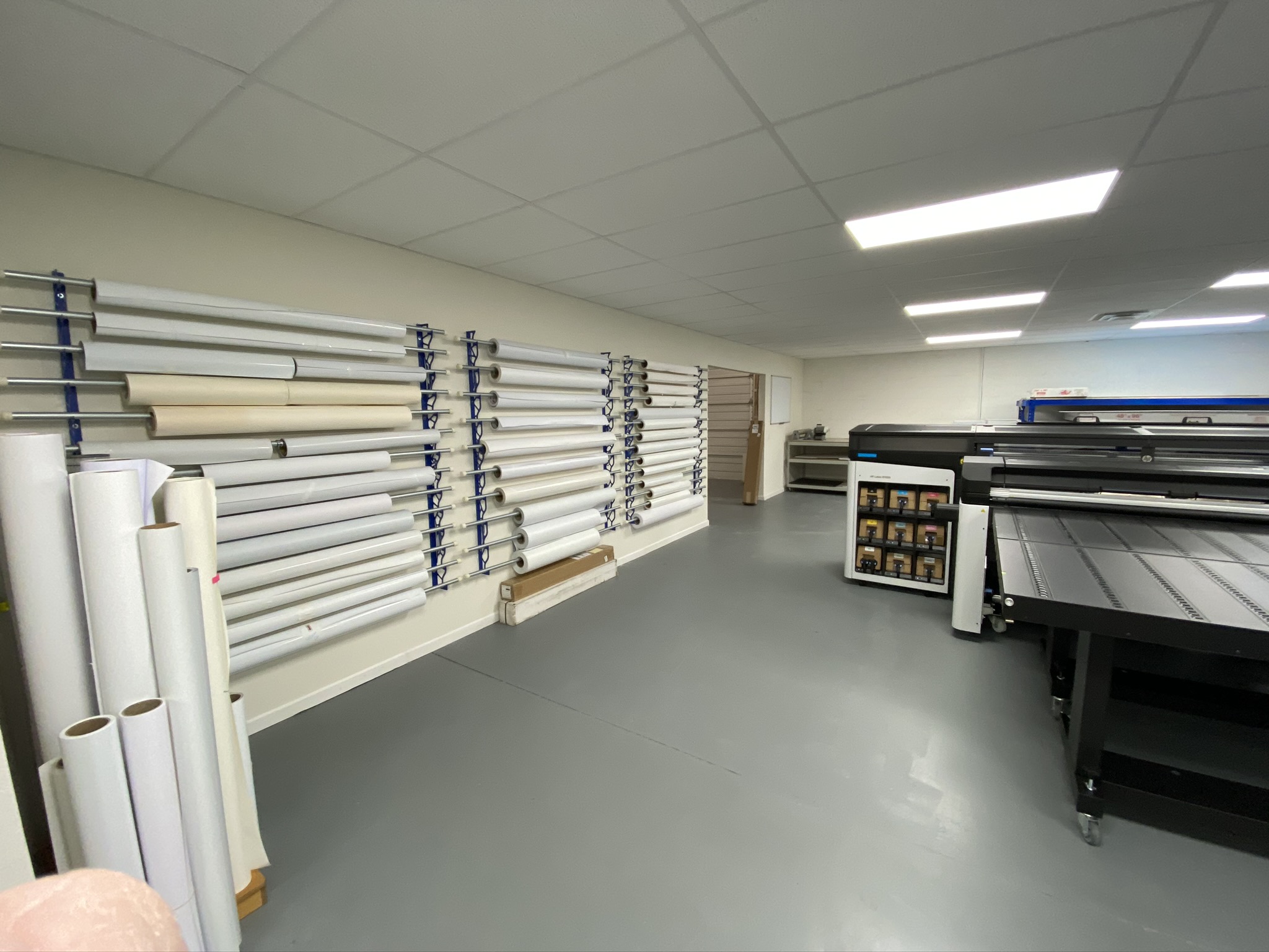

Made it with 1/2" conduit. Drilled a 1/2" hole at about a 3 or 4 degree angel in a two x 4, so he rolls won't slide off, screwed it to the wall, tapped the pipe in the hole, and badda boom, badda bing!

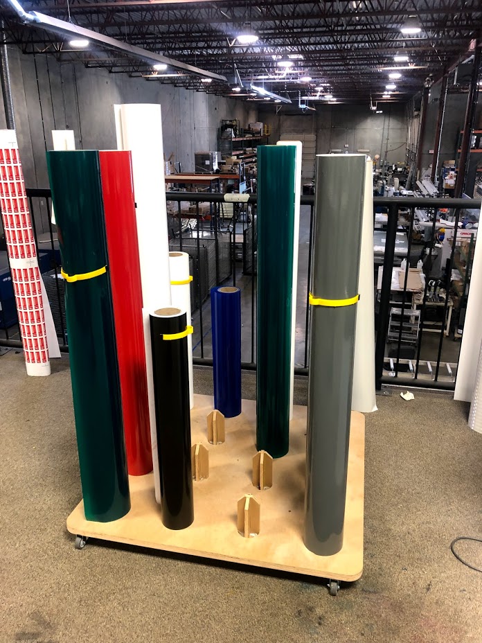

ikarasu
We have a few of these - I have one thats 2 wide 10 long for overlam, 2 wide 5 long for "finished / printed ready to vinyl", and 2 racks that are more vertical and holds 15-20 rolls each...cant find photos of the rest though. Pretty much everything is on wheels!

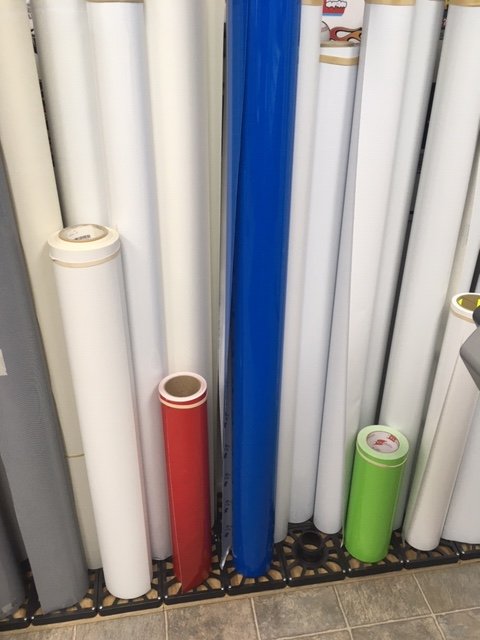

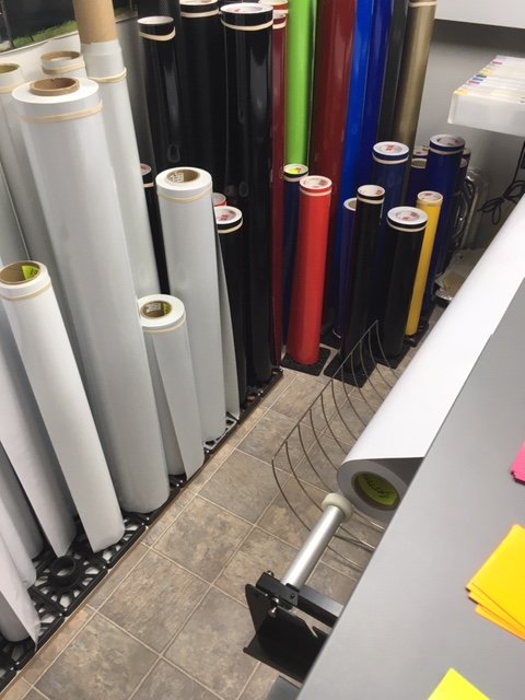

I made several of these "Floor Racks" for my shop and have virtually no money in them. When we get a roll of 54" 3M Vinyl or other brands it has the Black core supports in the box holding up each end of the roll inside the box.
We save them, cut whatever size scrap 3/4" plywood "base" we want and screw the black core supports to the 3/4" plywood. They are very sturdy, rolls stay standing straight up, rolls don't fall over & easy to remove the rolls off and on the black cores while using the vinyl rolls. The weight of all of the other rolls keep the base on the floor from moving when using a roll of vinyl. You could even build a larger plywood base and put several cores on it with Casters to roll around the shop....

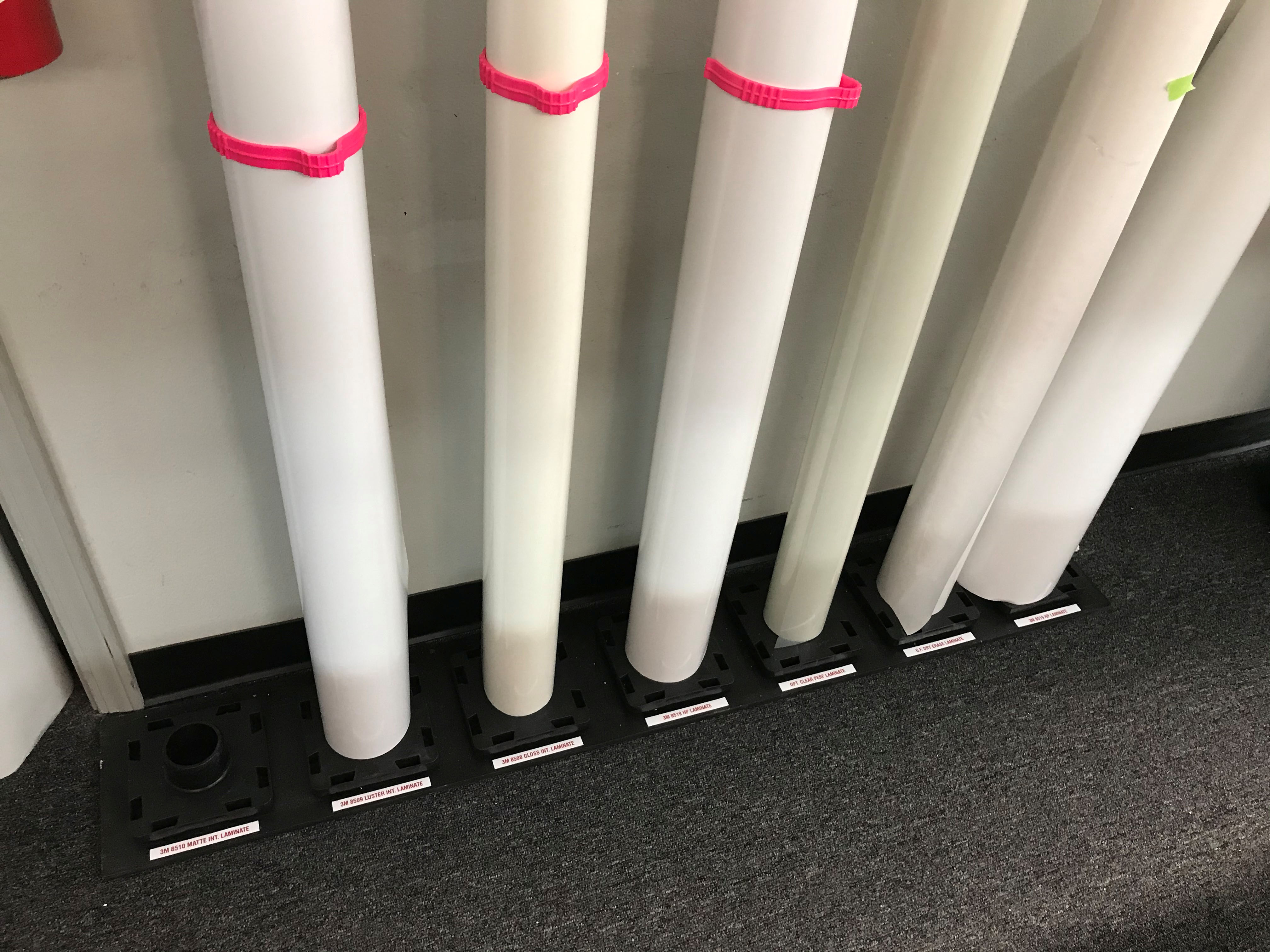

eahicks
Have several of these in the shop that we made with the core inserts and MDO strips.
