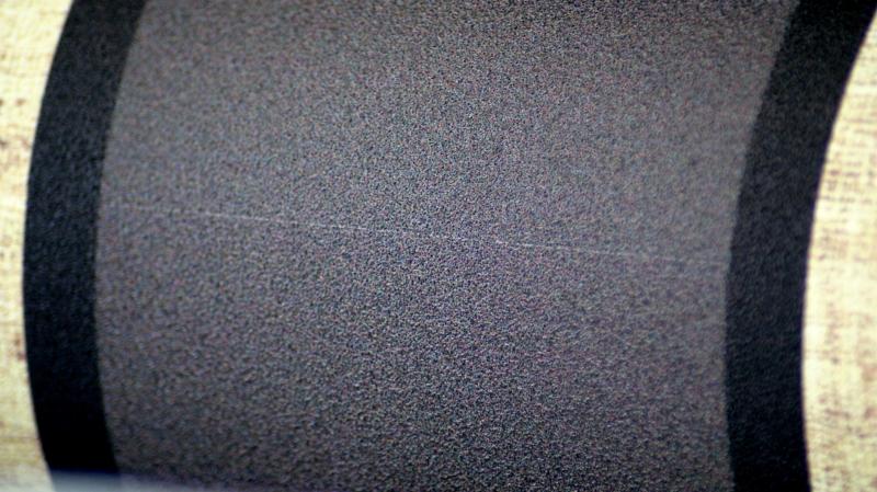

We are currently running wallpaper through our Roland AJ-1000 and are experiencing completely random white lines across the width of the print.
Some info:
1. Roland AJ-1000 (fully updated) / Rip in Versaworks (fully updated)
2. Artwork: Tiff, flattened - no compression (average size 600MB)
3. printing 3 pass - custom wallpaper profile
4. Print size: 1.3M x 11.3M / Each
5. Roll size: 50M ( we get x 4 prints per roll )
6. artwork construction: 3 files nested (1st is repeated, 2nd & 3rd not repeated), tile spacing=0, error diffusion on.
problem:
White line across width of print, approx. 1mm or less thick - all heads are not firing on the line. The line is mid-band (so not a calibration issue) and is visible as of first pass, the printer does not 'overprint' on the second and third pass, but instead misses the same line...

what is strange is the following: the line appears completely random, not at a band, nor a design repeat, but completely random in the print, for example we could have one at 3M, next at 8M and another at 8.5M...
Also we would print the same design say in a blue color-way with no lines, but then print it in charcoal and get lines..I then re-colored the blue (good) artwork to charcoal only to find the line is back?
We are completely stumped and neither Roland South Africa or Japan have any answers..anyone experienced this before or have any possible solutions?
