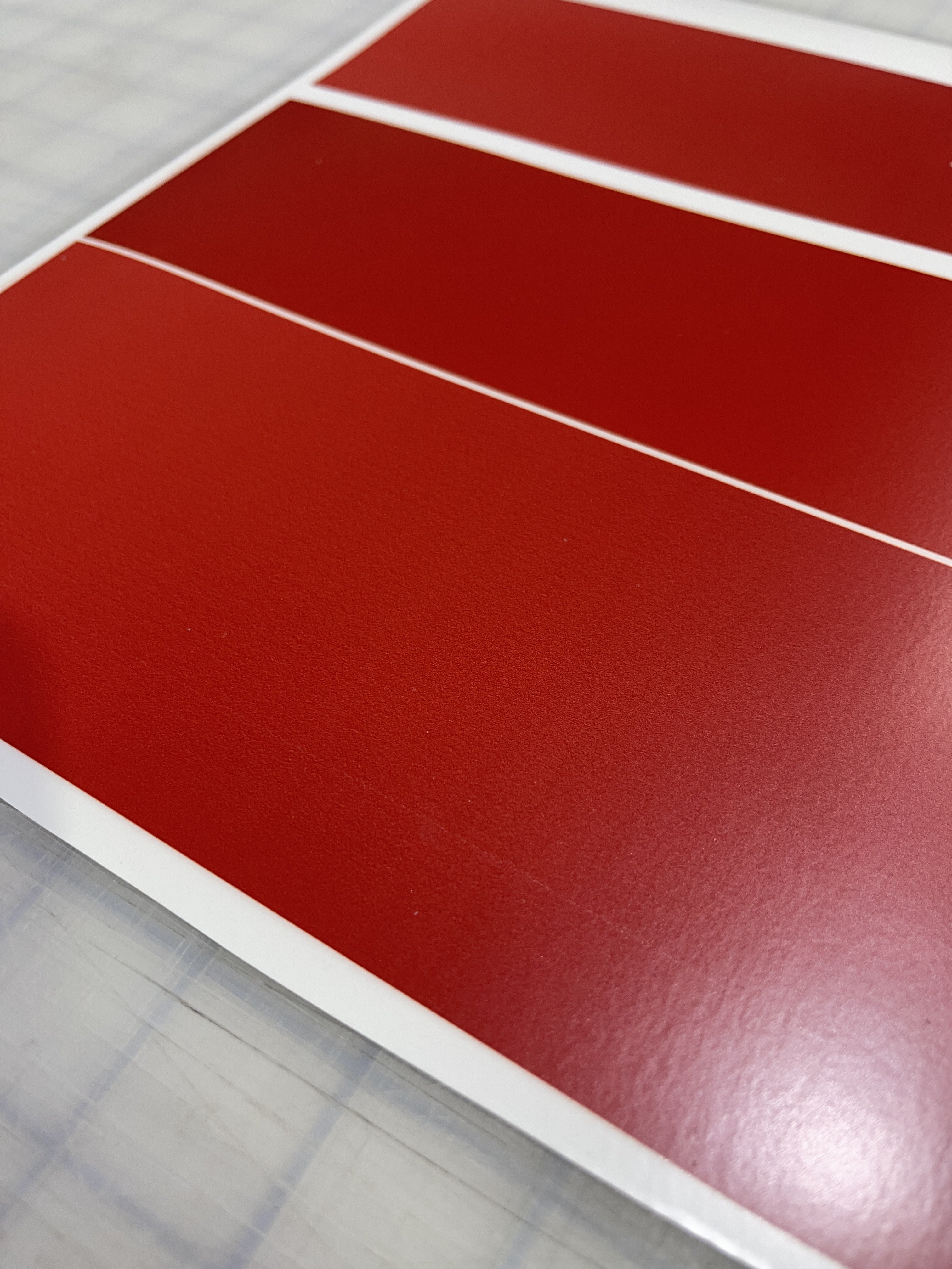

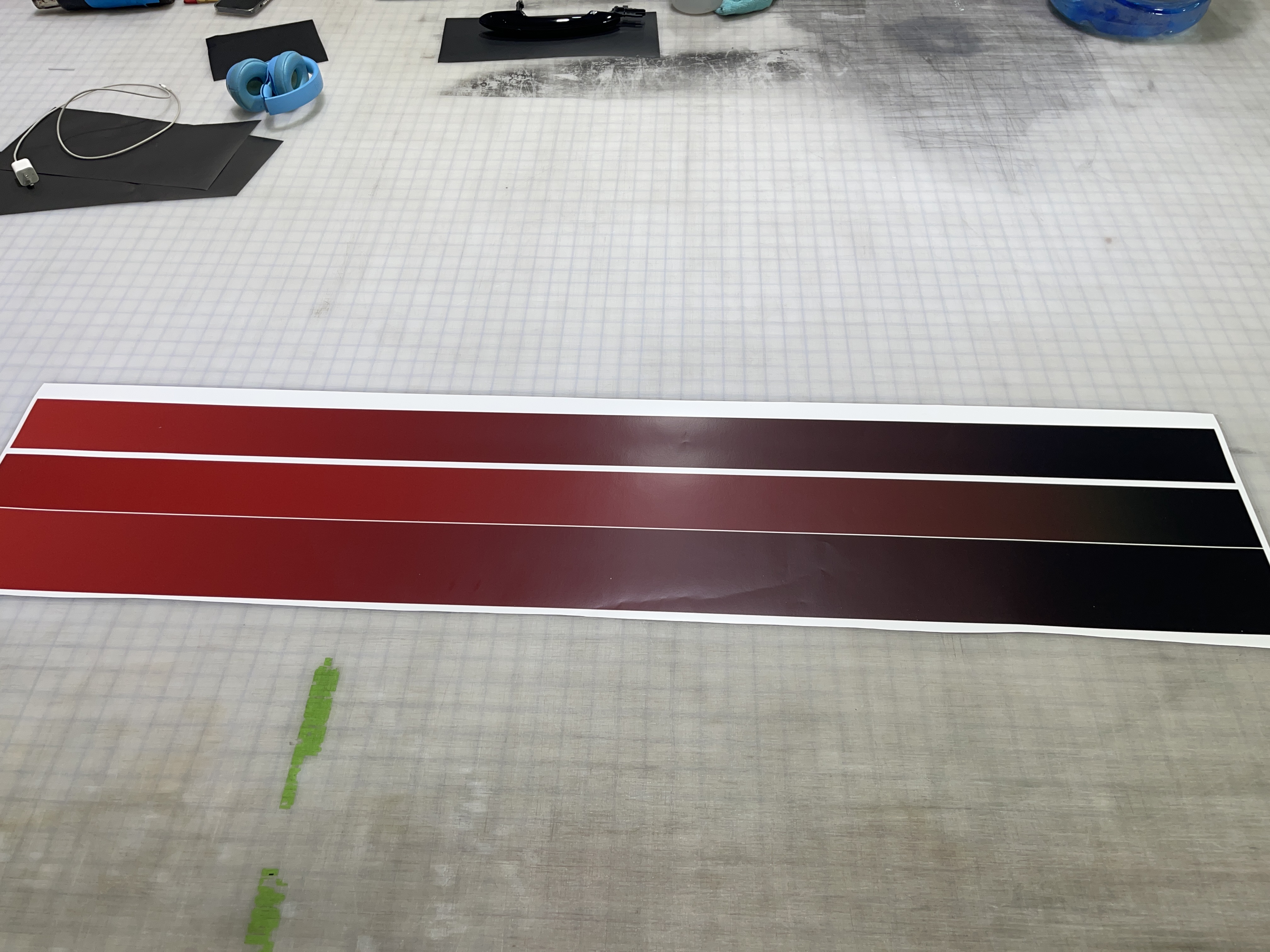

Hello everyone at the shop I work at I am using a Mutoh xpertjet 1641 SR pro, vertelith, and illustrator to create the gradient in PDF.
Just to give background, I have attempted to print red fade to black gradient before and have not had success. The only solution I found to work was to print black gradient on top of red film, such as satin 3M red.
This time it has been requested that I printed fully, and I matched the red color to an existing 3M smoldering satin red. I have gotten as close as I can to matching the red and I have my gradient at 61 inches wide.
I achieved a good gradient and prints. However, the red seems to be grainy. I’m using the generic cast 900 x 1200 dpi V3 profile. I really didn’t wanna go in and adjust the dot size because that changes the way any color looks. And I would have to restart my color match again.
My question is first has anyone achieved this red fade to black gradient well? Second question is how do I reduce the graininess without adjusting the dot size? Third question is what is your best method of achieving a gradient regarding from start to finish design, PDF, software, print profile, etc?
I’ve spoken to four different Support guys from Fellers. They’re generally helpful. However, the answer I tend to get with this particular issue is just try it until you figure it out.
I have a project that is due within the next week and I need to sort this out as soon as possible. Any tips advice or help would be greatly appreciated. Thank you.

One of my favorite methods to do a color to black gradient is to use the transparency settings in AI. You make a rectangle and set it to your red color. Then copy and paste the rectangle in front. Now you make the top rectangle a white to black gradient and then set the transparency setting for the rectangle to "Multiply". The standard gradient tool starts with the red color and then tries to adjust the CMYK values step by step until it reaches black. The method I described simply darkens the color step by step. It tends to look smoother and the color stays truer to the original as it fades to black.
As for the graininess, try turning the heat up on the printer and choose a slower motor speed if the profile allows that setting. It also doesn't hurt to check your head alignments to make sure they are spot on.

Bump! Does anyone have any better advice? I got the gradient good, but the red has lines. I cleaned and aligned printer head. did full weekly maintenance. No change. I recently switched over computers. This may be the cause. However, a higher up from Fellers support virtually set up most of the things. I know how to create environments etc. I could have set it up myself, but I let them do it this time.
Update on the project with red to black fade, we bought 3m satin smoldering red and printed black gradient on it. Came out great, much better than red print.

Are you using a rich black for the black color in the gradient? A red color transitioning to a plain 100% K black color is more likely to have issues with banding and odd looking colors in between than a rich black color that uses all four CMYK inks. Depending on the red color values and how things look in between it might be necessary to add one or more gradient stops in the middle to adjust the balance of the red color and black color in the gradient sweep.

Crazy concept, but if you're trying to match a colored red film why not just print a black to clear gradient on that red was your substrate? I know it's not technically the "right" thing to do, but I've printed on various cast and calendared colored vinyls with plenty of success in the past. May have to play with your profile just a little but I bet you can make it work.

Might be an option that you have checked/unchecked while you are saving (like documents effects resolution, compatible with gradient printing, etc, etc), or maybe even a RIP setting that is causing graininess.
For the fade itself, you need to have the colors set to the CMYK you like at the start of the fade (just say you used 3/100/100/0) and then fade that to the rich black at the other end and have that be "3/100/100/100" for the blend/transition to be smooth.
