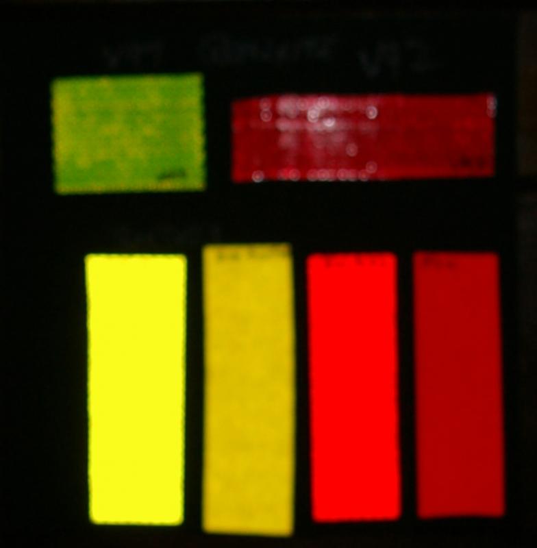

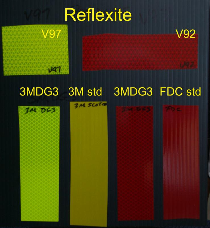

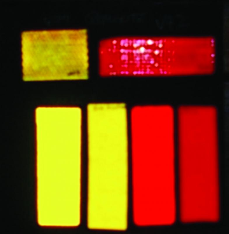

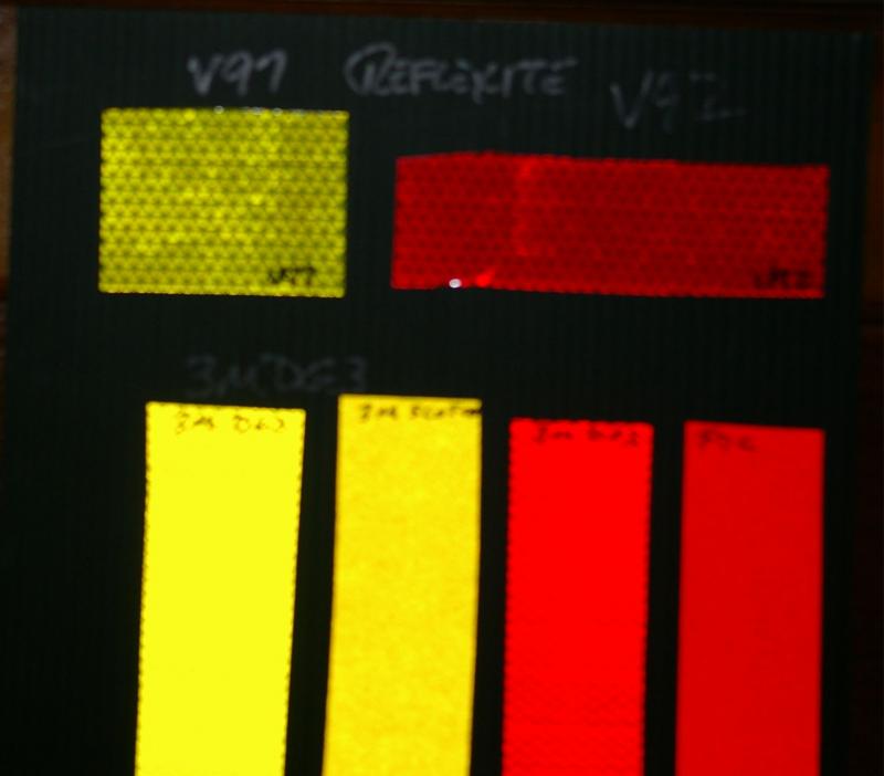

Ok.. with the winds howling as they are here, I doubt I could fasten the board anywhere and have it stay, at least outside. So, a long hallway darkened as far as I could is going to have to do. Camera is an older digital SLR on automatic settings, using the camera flash. Nothing else was added or changed.
First photo - test board. Nothing special, just strips of the stuff on a black piece of coro. Four types present - Reflexite, 3M DG3, 3M "regular" and FDC "regular":
Second photo is from about 6' away. Not really focused, but you get the idea:
Third photo from about 10' away.
Fourth photo I purposely focused on the Reflexite section
