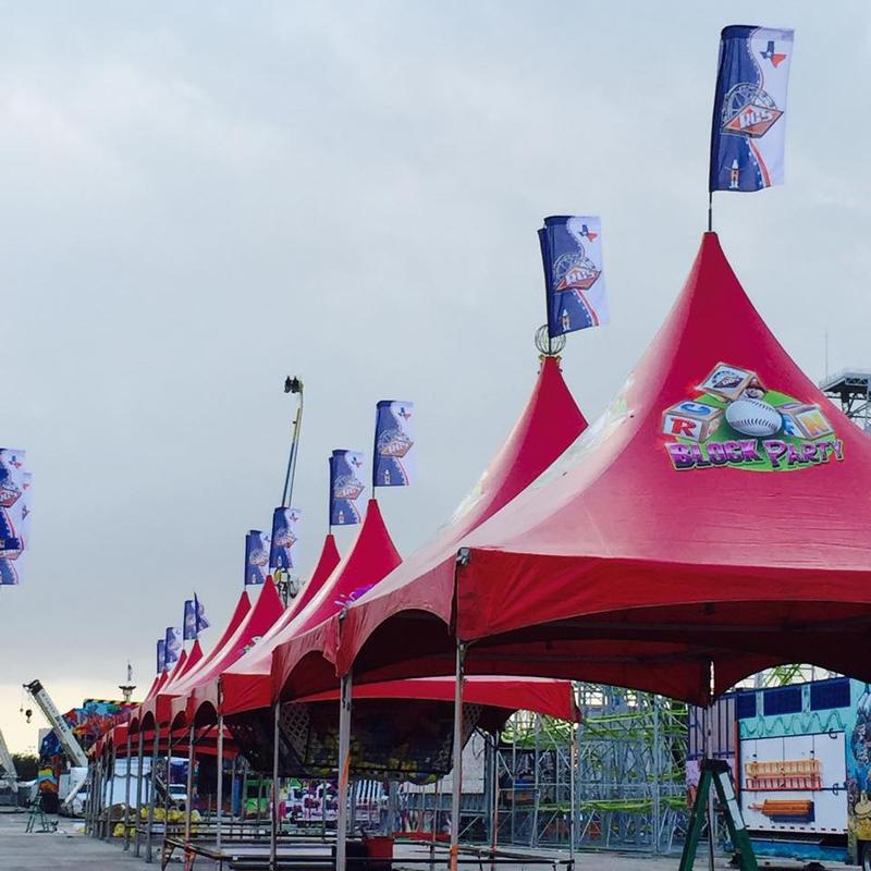

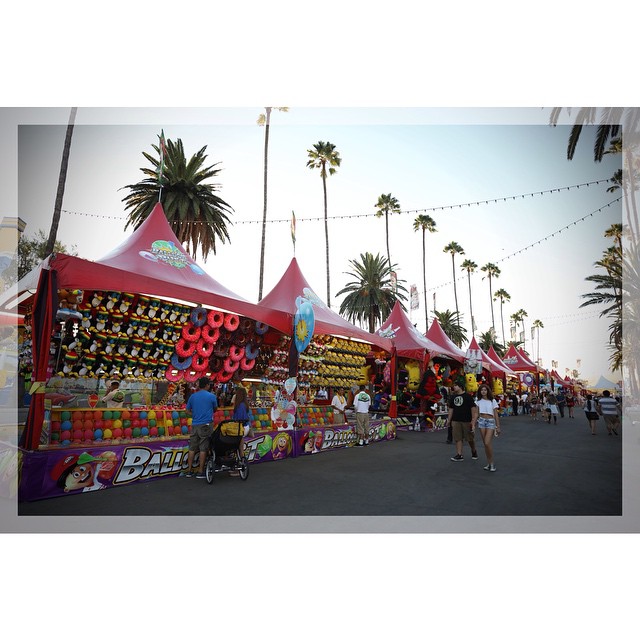

3M 480Cv3... I do about 150 decals a year for a fair company the last 2+ years. We do them 52" x 72"
Oracal 3169, the removable version of 3165? No lam for short term use and it's removable for 3 years. Should work fine for your needs and it's cheap.
Christian @ 2CT Media
We went through ij35, 40, 180, oracal 3165, 3651, 3169, 3751, Avery 1005, and arlon 6000xrp before realizing that 480 was the only thing that stocked well and didn't curl in the heat. YMMV but take it from 4 years of trial and error in that industry.
