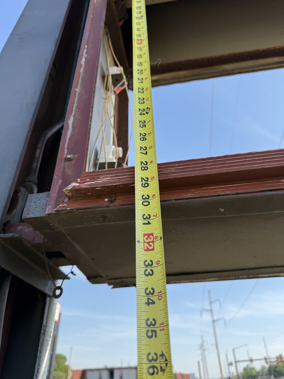

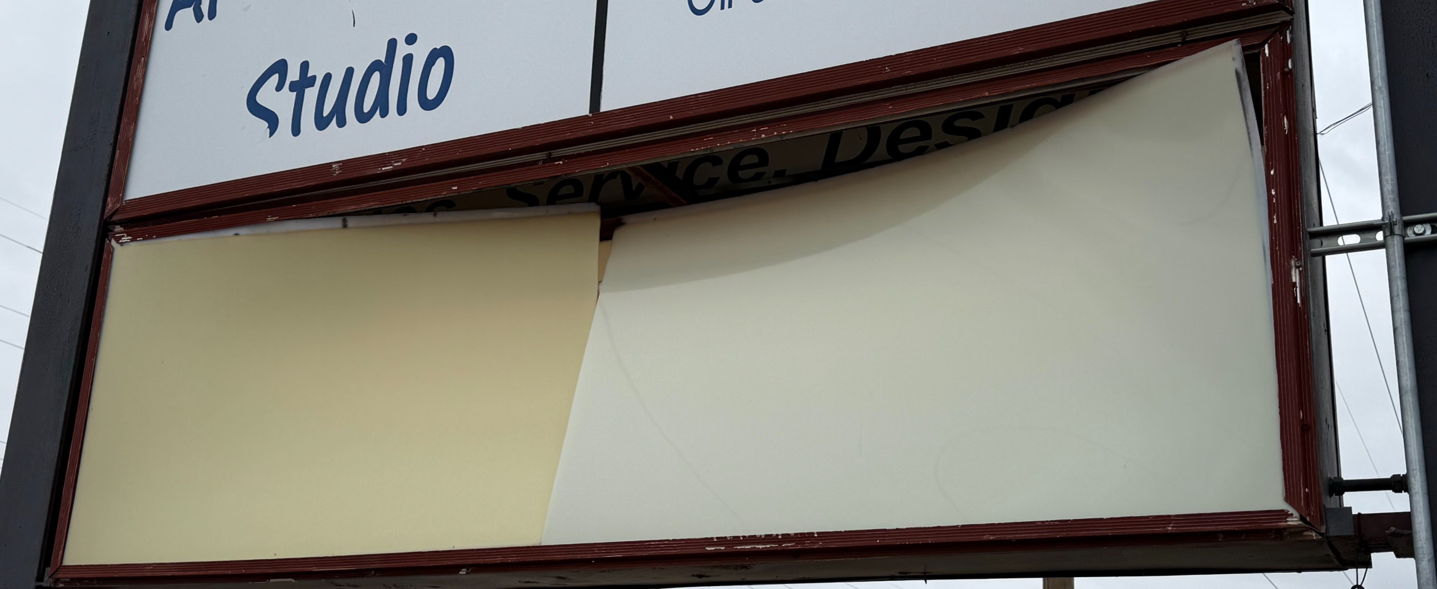

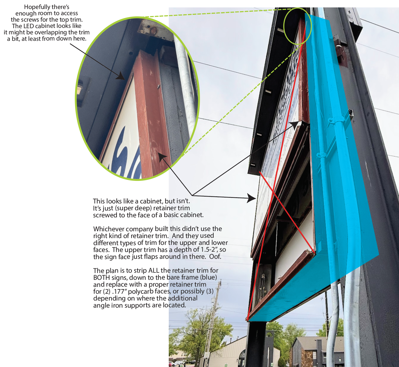

While replacing some sign faces I discovered this really old retainer trim. Much of the trim is beat up pretty bad. Missing pieces, twisted from sign face blowouts, etc. Not sure why they used a double track profile, but it's certainly not needed.
I think these cabinets are at least 40 years old.. It looks like the previous shop built a very basic steel cabinet and installed retainer trim pieces to the face -- no fancy kits.
The client wants me to replace all the trim for (2) different (stacked) cabinets. 1 sign is about 96" x 60", and the smaller one (pictured) is 96" x 30". Current trim depth is 1".
What type of trim would you recommend as a replacement? A simple "h" profile with a 1' depth? Reece / GSG recommend Excellart for profiles, but I didn't find what I was looking for... so I need to find a supplier too.

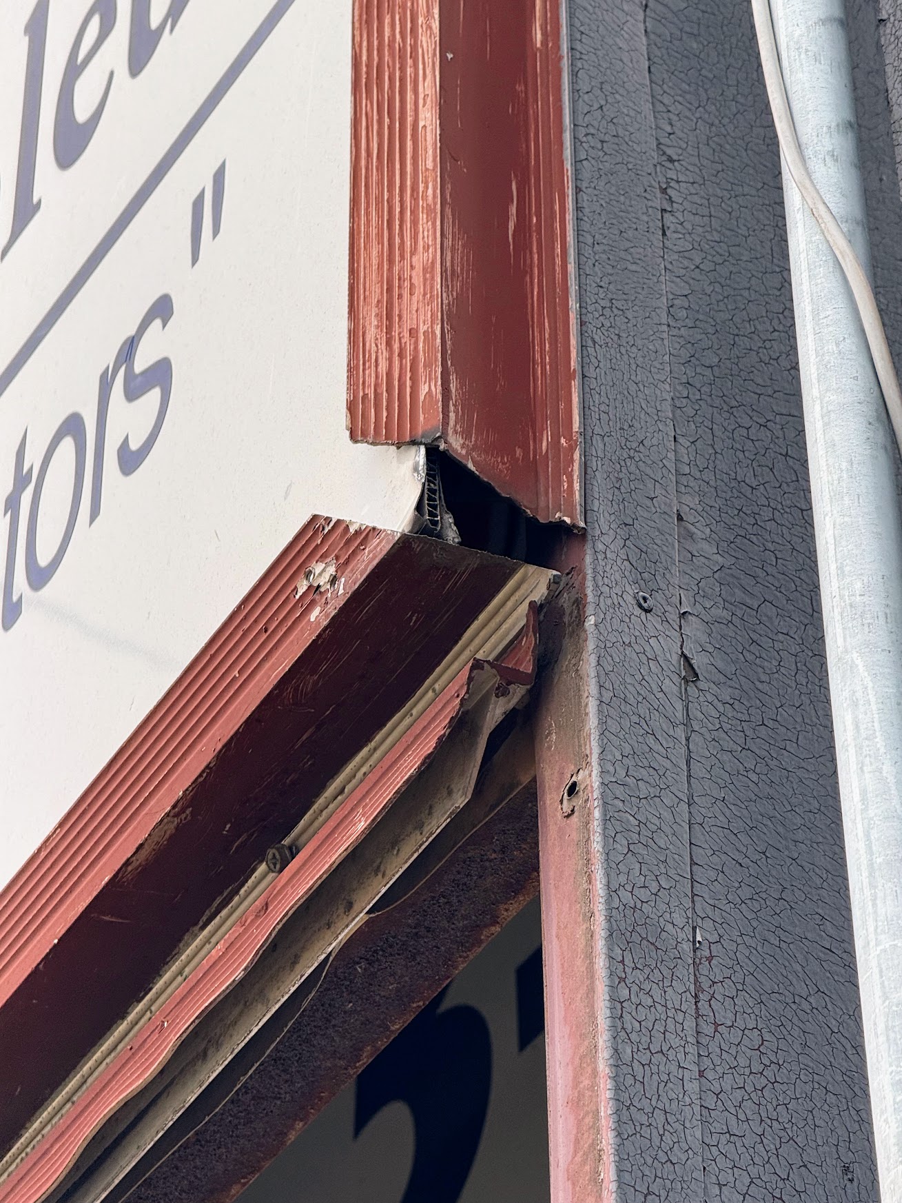

Yeah, I would probably do that for a single cabinet if I could access all 4 sides, but this sign has several sections stacked on top of each other so I need trim that attaches to the front. It's a funky build.

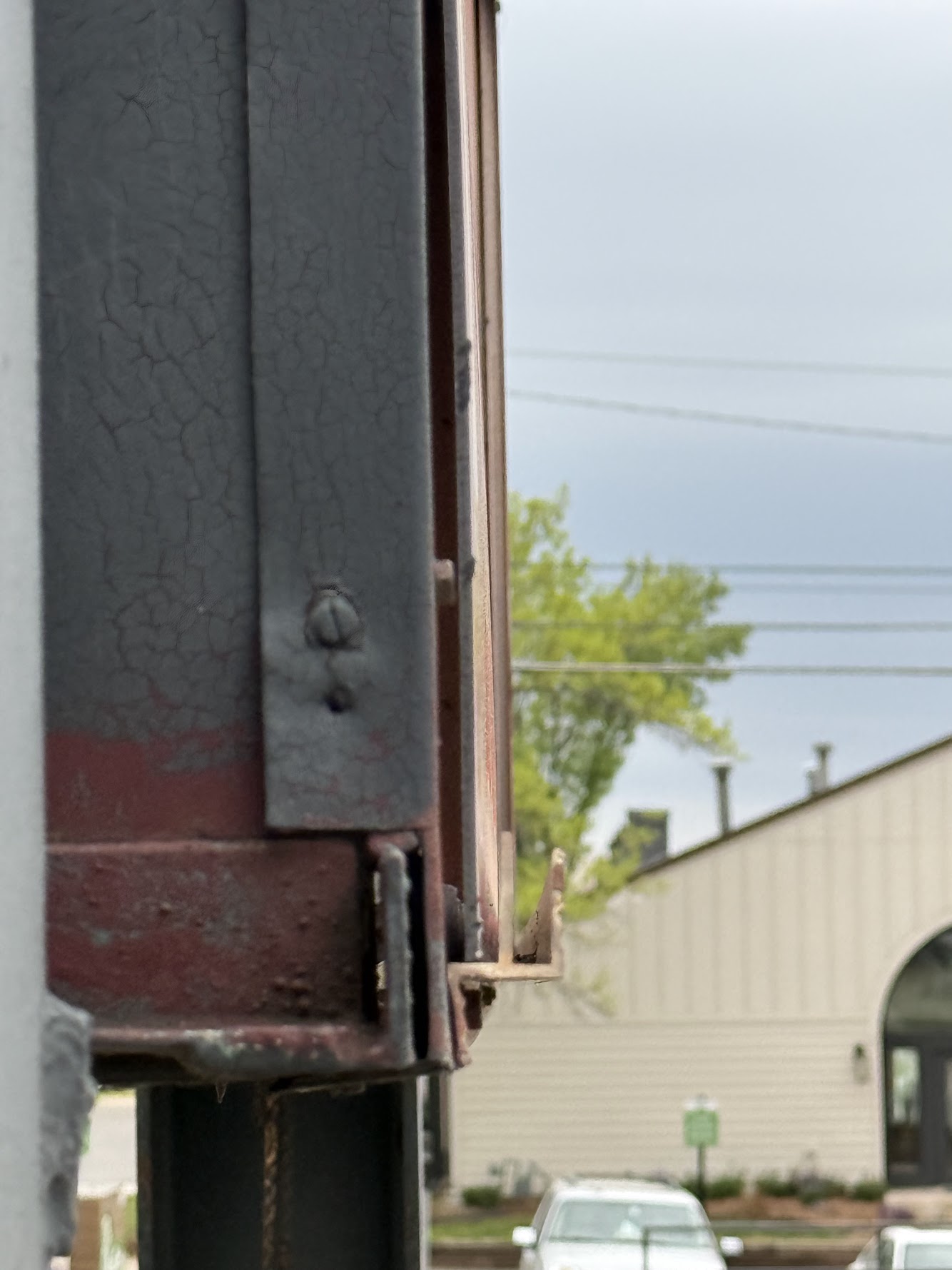

You could get away with some Z clip as long as the inside of the frame has somewhere for the face to rest against. Your first picture looks like it does.
That I beam has seem quite a few signs come and go over the years it would seem!

Yeah, this sign has been beat to death over the decades. And whoever fabricated these cabinets... it seems like they built everything using scrap from their cabinet bone yard because all 4 cabinets are different thicknesses. lol. I don't have to do anything with the top 2 cabinets, however, since those were retrofitted with other systems over the years.

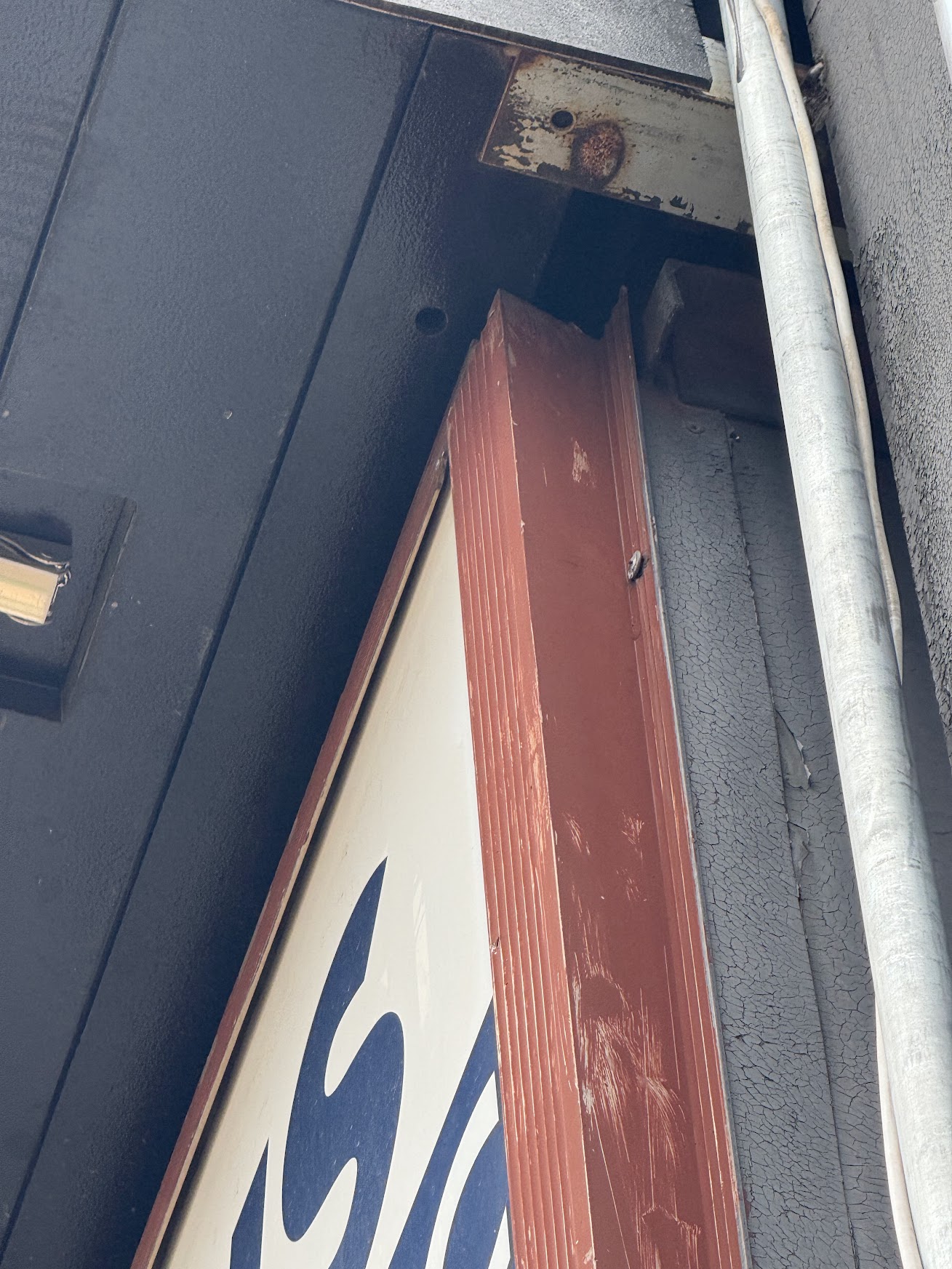

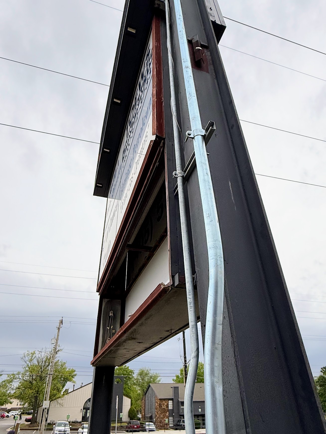

I could do that for the sides and bottom, but that probably won't work for the top and middle sections. Check out these pics (yep, it's janky. lol)

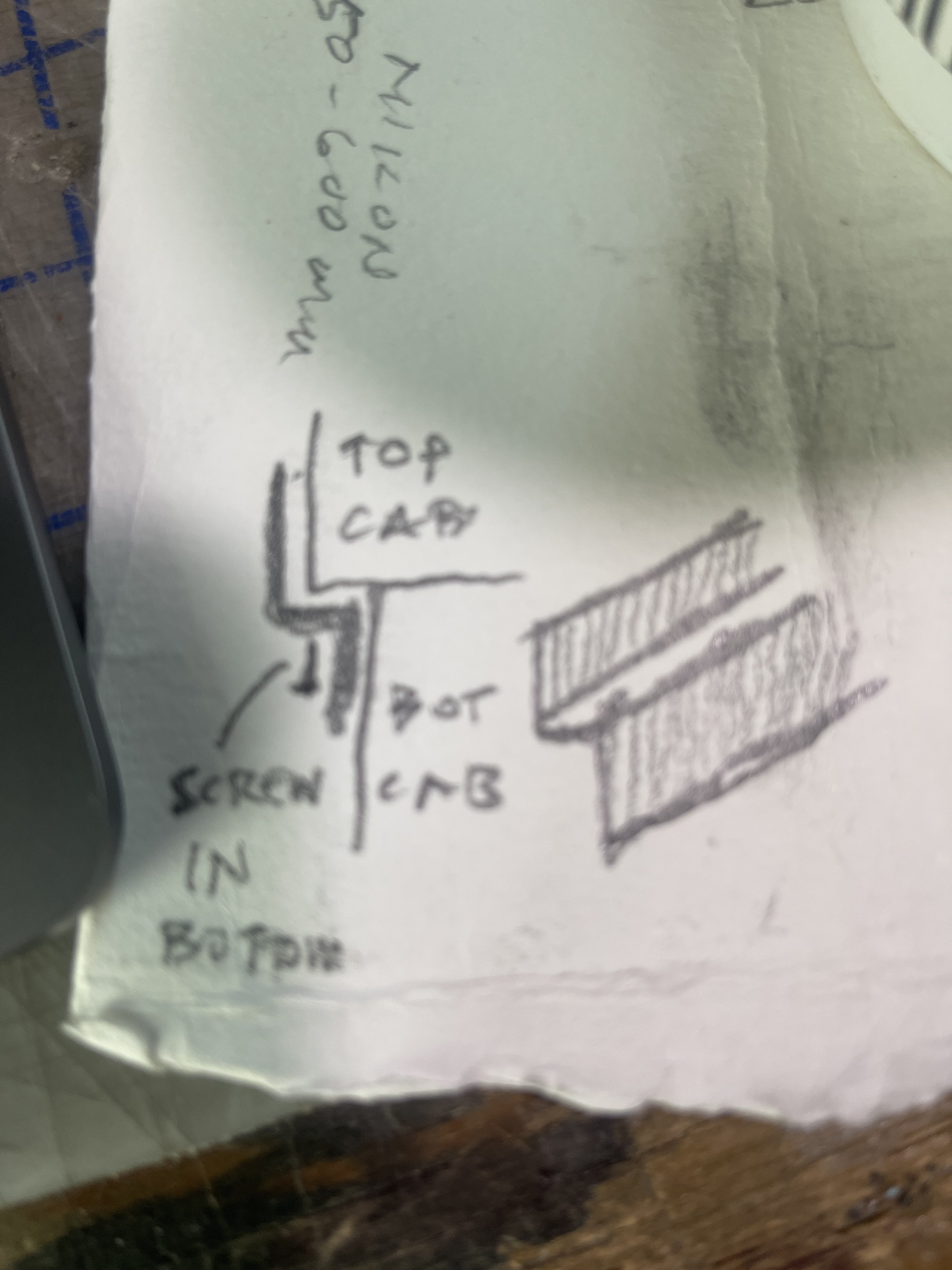

Johnny Best

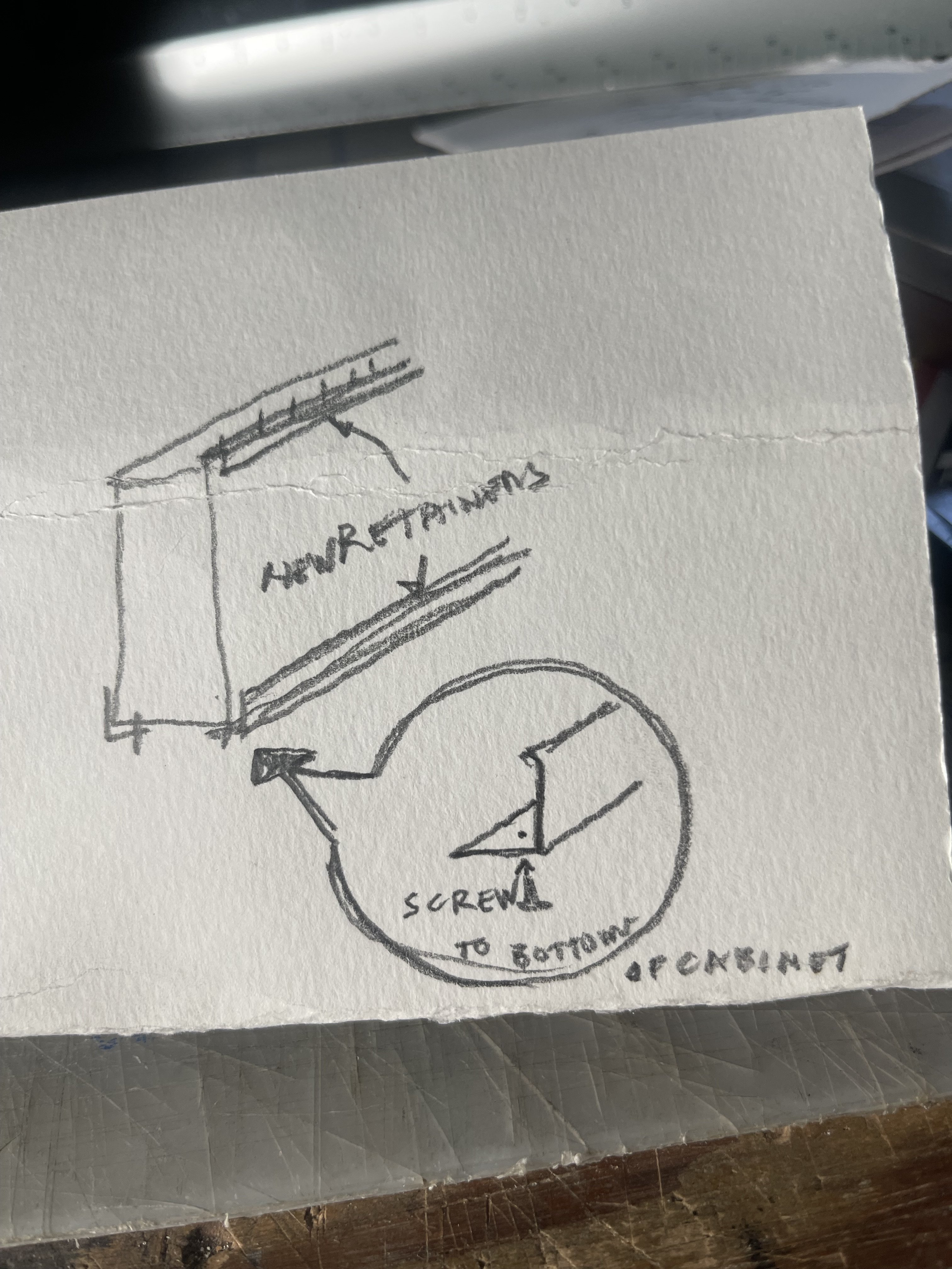

Looks like top cabinet sticks out further than bottom one so retainer can be fabricated like this.
I think the customer needs new cabinets. You can only patch so much, you might have a problem with getting screws to hold in rotten metal.

tulsagraphics
That "upper" sign looks like an old cabinet, but it's actually a really deep retainer trim. If you notice the Alumalite face in there, it has no support behind it -- it just flaps back and forth in the wind.
The plan is to get rid of all the red retainer and go back with new.
Upper sign is ~8' x 5', bottom is ~8' x 30". Depending on where the supports are installed, we might break this up into (3) signs instead of staying with (2), because an 8' x 5' plastic sign face doesn't last long with our crazy winds. (that's probably why they went with Alumalite on that upper sign, if I had to guess).
