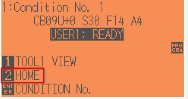

Pressing the [2] button should take it back to the home or origin position:

There's . . .a . . . home . . . function? I mean, I've seen it - not once did I ever have the curiosity to actually use it. I can't wait to try it now! No more pre-tracking some 24' job and then holding the arrow keys for 2 minutes like a moron? :p
