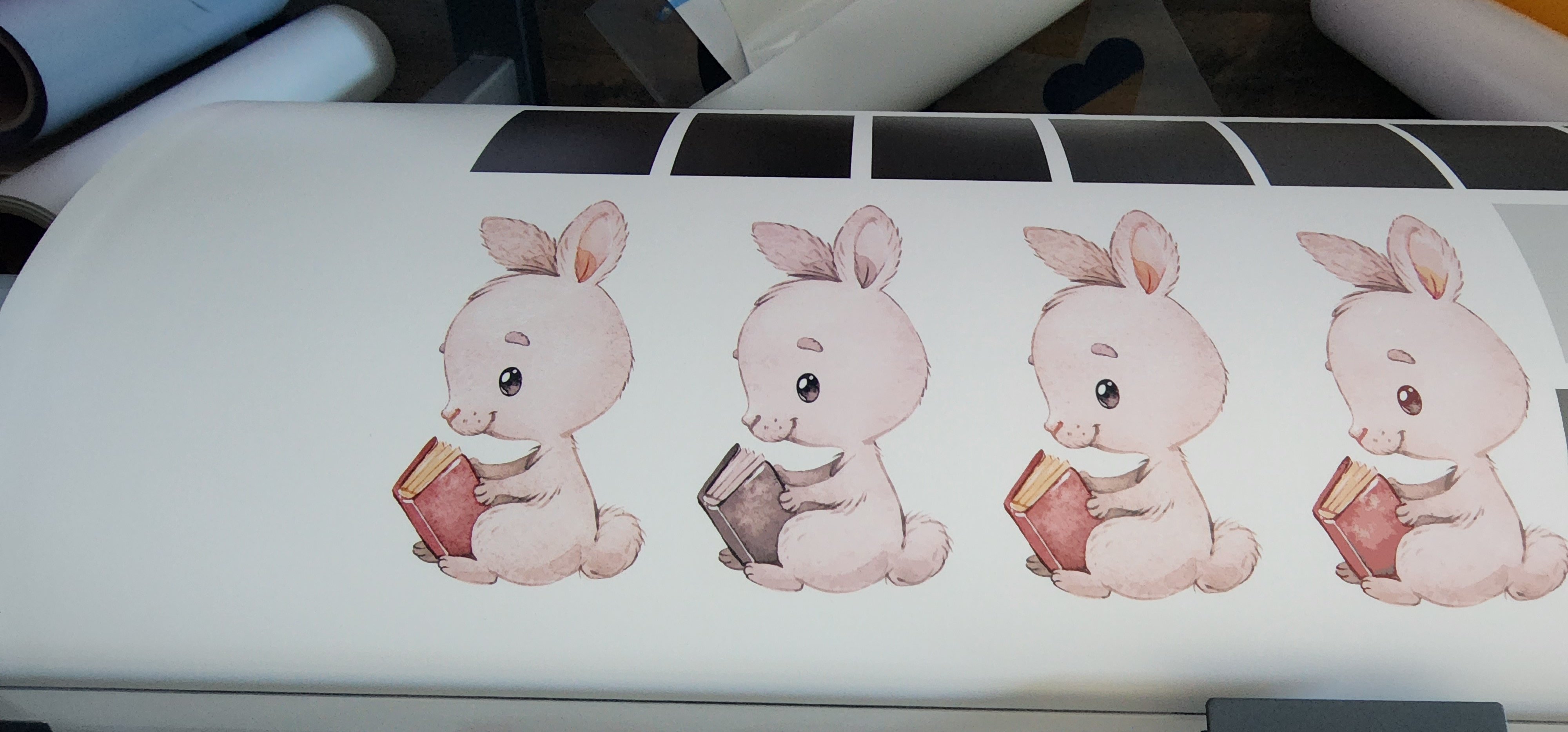

I have some problems printing grays on my versacamm.

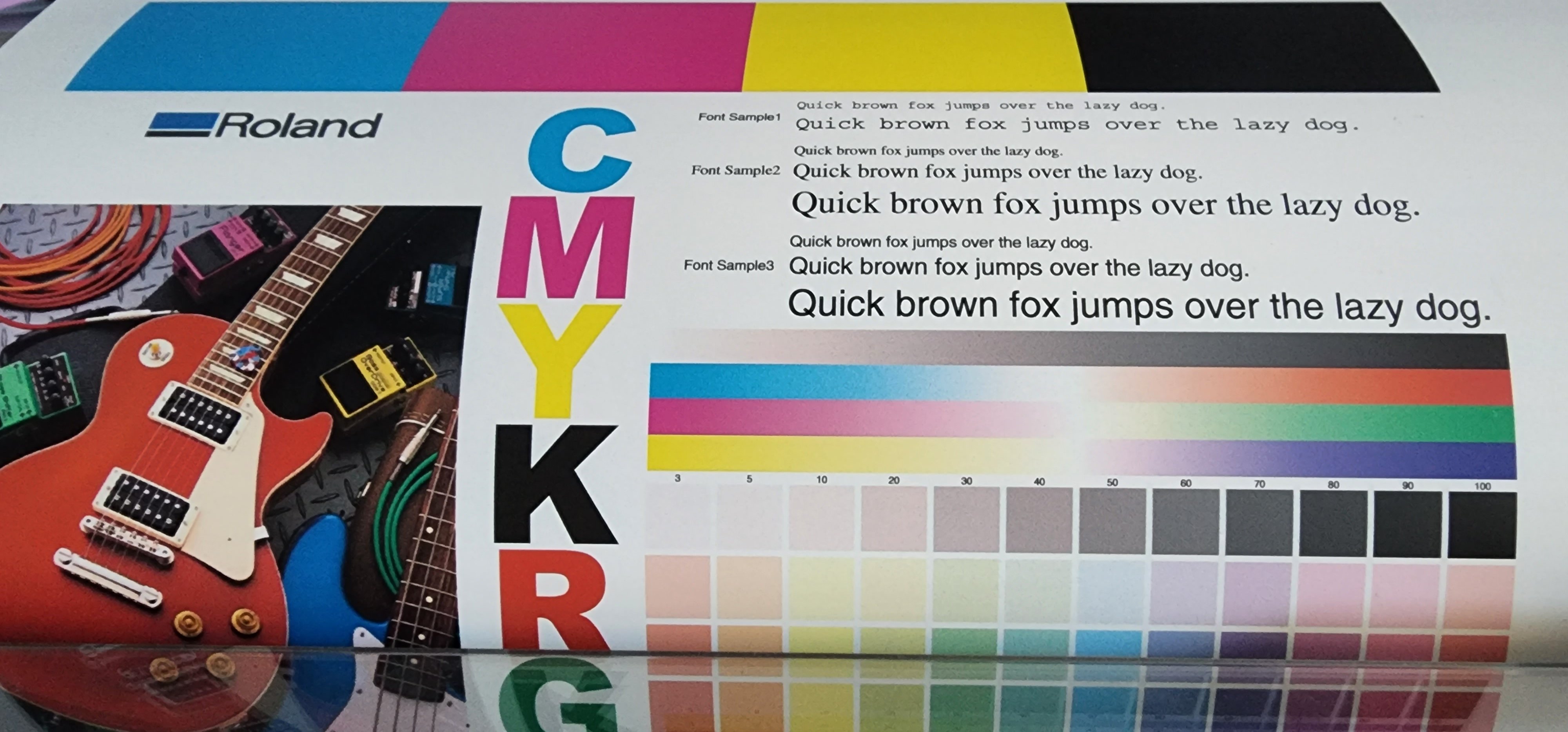

I did Roland test print and it came out with pink tint. Is it print head issues ?
I need to print some wall decals for kids. File is PNG format. There is one gray bunny which is printing in pure pink no matter how hard I try.
I'm using wall flair wall fabric material. I tried density control only and all other settings I could think of. No change at all. I also printed some grays from Roland color library and they came out as grays.
I did multiple prints to test and no matter what, on wall flair material bunnies are pink.
So I tried to save it in pdf and RGB format - no change, on wall flair material all pink.
I did test print with 4 different bunnies, from left to right : #1 bunny is png file , # 2 is vector traced in gray, #3 and #4 are vector traced full color bunnies.
I printed it on some t shirt vinyl and it came out pinkish but decent.
then I tried sign vinyl , only grayscale traced bunny came out as gray the rest are pink.
I tried on wall flair all bunnies are pink.
Can anyone help me solve this mystery ? 20220924_151034.jpg 20220924_151435.jpg

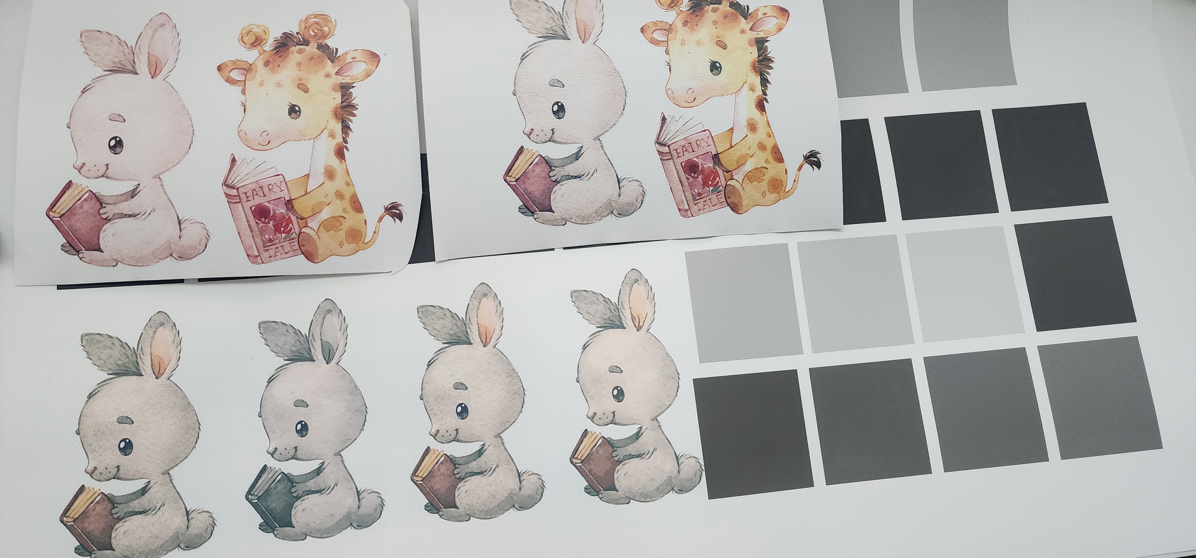

I don't think it will solve all my issues but I ll look into that.
Any .png or .jpg file with gray printing pink. On any material I use.
Only colors from Roland library print as grays nothing else.
I was wondering could it be printhead issue ? Since there is some pink in my color print test.
I never had this issue before. All my printing profiles used to work just fine as it is. Today I'm printing some stickers and they are printing pure pink instead of gray.

nozzle test is fine, but color test print is printing printing grays as pink. At the same time machine can print gray Roland spot colors no problem. I'm emailing with Roland tech support . So far we tried many different things and no improvement at all. Lets see what will happen. I ll post here if I ll find the solution.

I understand. But I didn't have this issue before. I want to know if something wrong with my print head or not.
I used to print on sign vinyl and other type of wall vinyl without any issues. Right now even on sign vinyl it is printing in pink.

interesting. I never had issues with gray. Earlier this year I printed Roland color test print and it was just perfect, Test print I did couple days ago has pink gradient instead of gray. when I reduce magenta in color setting it literally does nothing.
