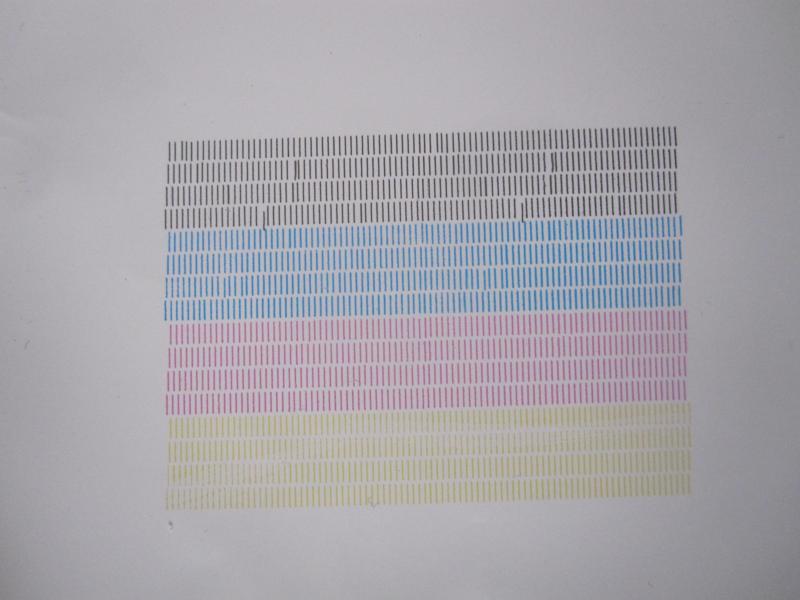

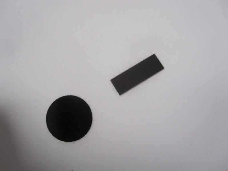

i have just bought a roland/cadet sp54"
when i am printing the crop marks they are all fuzzy around the edges
so the printer will not pick them up, also there is a slight fuzz to everything black,
i have performed a head clean and soak, is there anything else it could be or am i going the wrong way?
i have attached a few pictures to help
could it be the encoder strip??
Cheers

inthesignbiz
You might see if the print head is raised or lowered.
Lowered gives sharper prints.
We raise the head on banner material
dayi1000
Do i flip it so the part thats been in the clamp in on top?
or turn it round so what was at the back is now to the front?
Cheers
FrankenSigns.biz
Turn it around so that the back is the front. Do you have a local Roland tech? You can always call Roland to free tech support as well.
