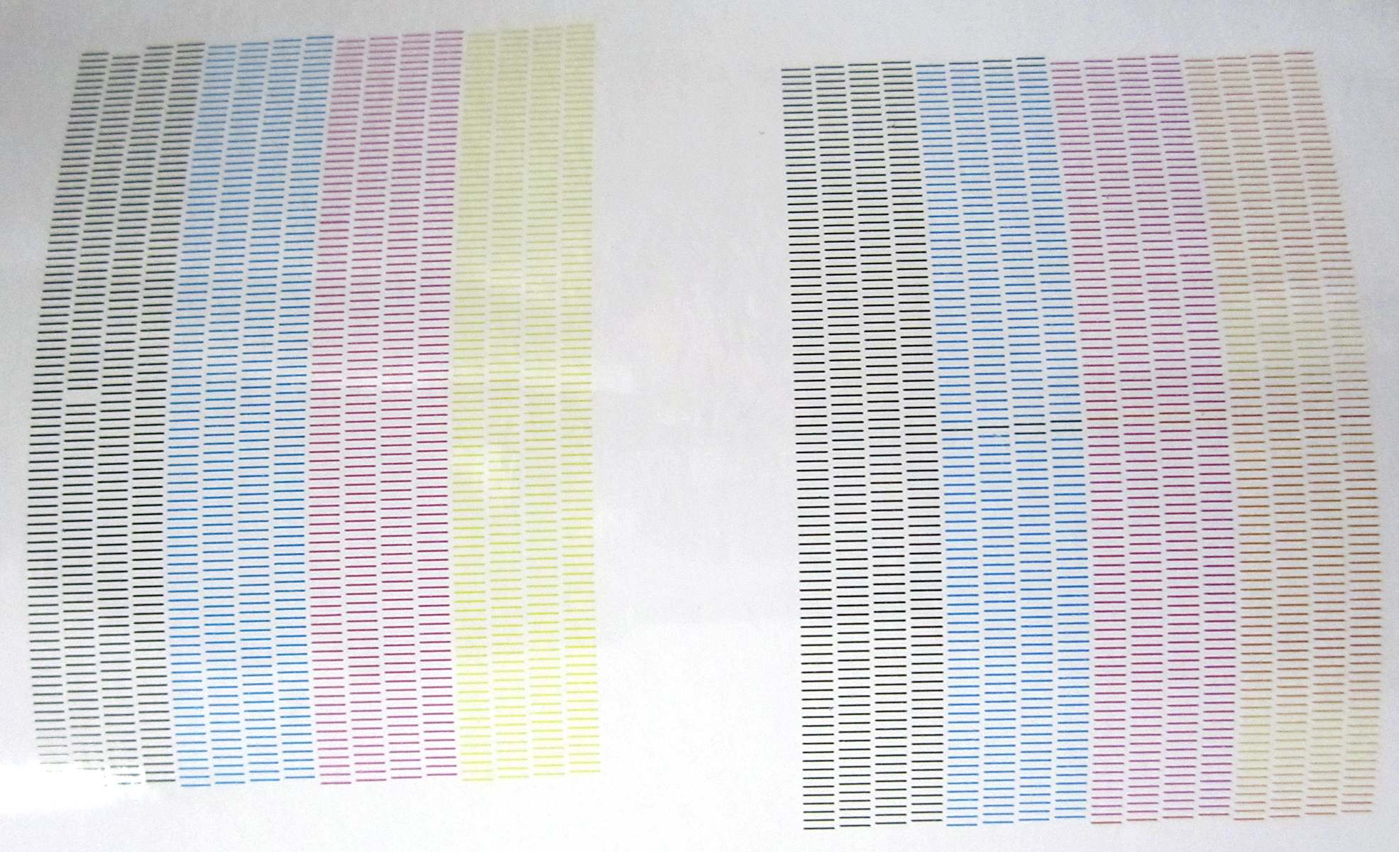

Since a few days my Roland SP540-V has a problem because the colours mix in printhead.
There is magenta in yellow and black in cyan.
The print result is bad. Yellow looks brown and blue is nearly black.
After i do one! medium headcleaning, everything works great.
Both printheads and captops are 3 months old and didn't have done much work yet.
Here is the nozzle-check. On the right side before head clean and
on the left side afterwards:

Usually cross contamination is caused by a bad / partially clogged cap top or a weak damper. If the cap top and dampers are older than 1 year, I would just replace them. Also, we've tried many different aftermarket cap tops and they just don't seem to work well. If you are using after market ones, consider switching back to OEM. While your in there, you might as well flush the waste / pump tubes to make sure they aren't partially clogged.
Gnarly
The Captops were replaced with the new heads (~3 months) but they are not original roland.
The Dampers are a litte bit older, maybe 2 years?
Today i cleaned the pump tubes, but it doesnt get better. I think i will replace the captops, the dampers. Should i replace the pump too?
