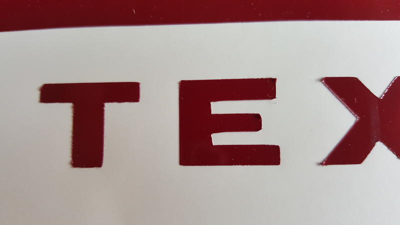

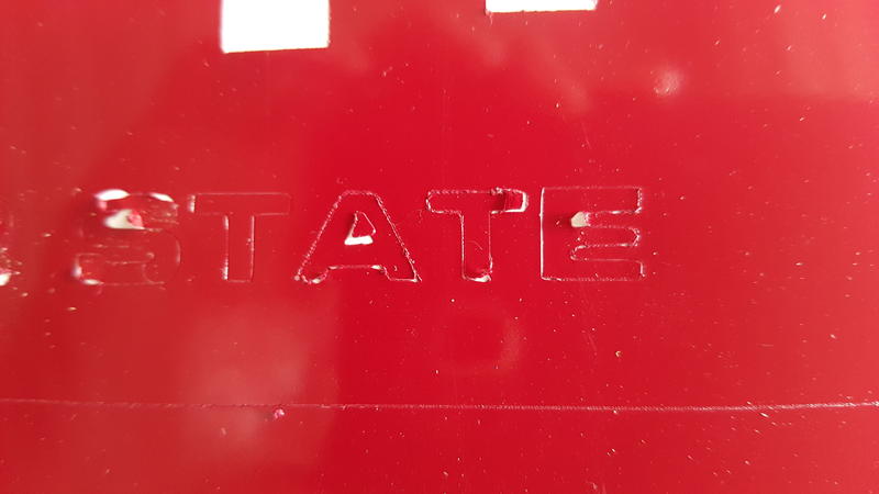

Roland camm 1 cutting issues
OldPaint
need new blade #1..........check cutting stripe make sure its not all cut up. make sure the bearing in the blade holder is rotating.......
decalman
I have got that to a much lesser degree sometimes, after blade , and cutting strip change. Certain fonts can do that too. ( mind boggling) There's also an adjustment on the plotter
