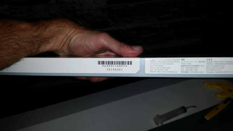

Guys and Gals I wanted to share this batch number with you. I received a new eco-sol max cartage marked yellow but when I installed it yesterday it filled the lines with magenta! Check your stock. My local supplier had a tech here at 8 AM to replace and correct the problem at Roland's expense. Just wanted to pass it on!

I didn't have to speak to Roland direct but Graphic Solutions has reported it to them. They had a case with 4 out already.(DFW) GSG was awesome and had seen it once before. They sent a tech the next morning and flushed and cleaned the system. They replaced dampers and cap and made sure everything was fine before leaving. I am sure we will see a bulletin soon. The work was performed yesterday. It just cost me a days production on that machine which runs nothing but dye cut work.
