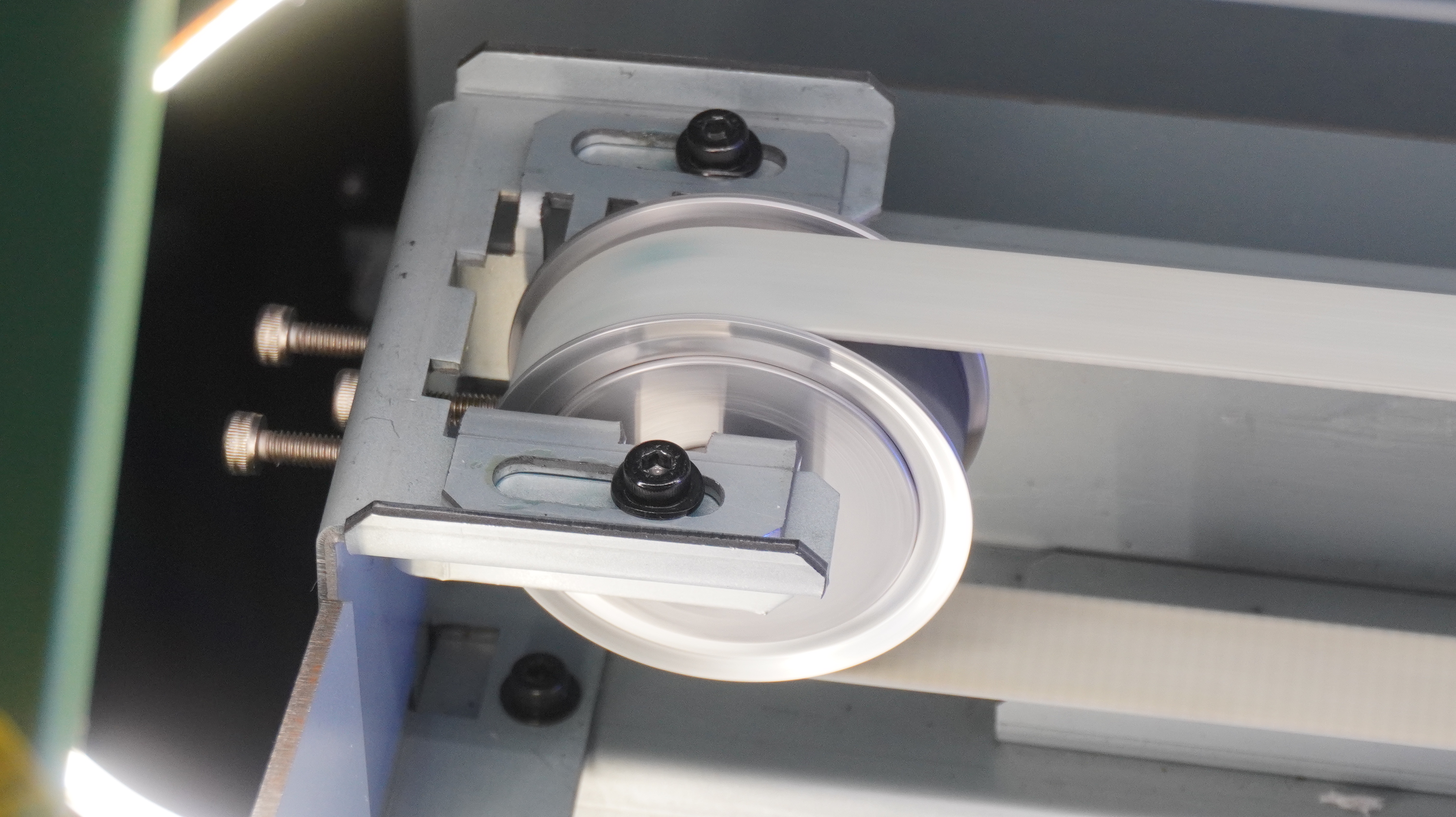

P U L L E Y gear and oily screws!
& B E L T
Okay guys was it me? or the previous owner
BELT Pulley holder has some small screws and look like they were oily!
Here is some things i did to help others!
cleaned the linear rail with a scotch brite pad green
Isopropyl alcohol the liner rails then used a dry clean cloth
cleaned the belt
Still issues!
so took of pulley device screws looked oily so washed them all with washing up liquid to remove the oily substance
dried them all
used small LOCTITE On screws
TIGHTENED THEM ALL UP
DONE:
Limit Position Initialization proceedure tHANKS Joseph44708
NOW SHE IS 100% AGAIN
So what was the cause?
It was the Belt pulley gear on the left hand side and if those screws are loose or had oil on them also the
It was a little bent, screws loosened, = the issues i had
So anyone else ever have this issue also check the Belt pulley gear on the left hand side mine was a little dirty oil around there etc that all needs to be bone dry
