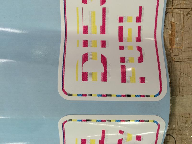

I fear that my trusted Roland PC600 printhead has bit the dust. I ordered a new one from RIESPRINTING in Indonesia today. They said it would be here in about 3 weeks. I am a little concerned about ordering from this far away, but it does not appear that anybody in the US has any.

It's 3 weeks for delivery. I did find a service manual and downloaded it. It looks pretty straight forward. I just hope it pops in and works. The current head started to get lines in it. I cleaned the head several times and got it looking good, then in the middle of a print job I lost almost 1/8 in the center of the print head.
If anybody might know of what else would cause this, please let me know?
